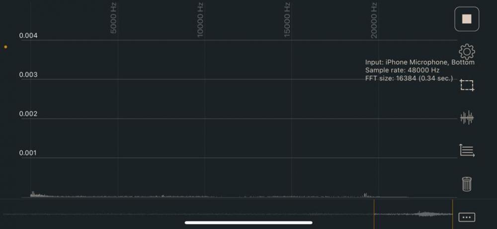

100%, I took my brand new 5kw inverter in to Sunsynk due to this 15000Hz noise it is emitting through my devices in the house. Working from home I would get a headache after a day in front of my PC.
Over a month passed when they eventually called me to say there is nothing wrong with the inverter and people with super sensitive hearing might pick up on the noise it emits. Now to me this is not acceptable and I have escalated the matter to a manager who's email address they gave me. Still awaiting further feedback.
In the other threads there are reports of someone getting a replacement inverter that did not make the noise and another member bought two inverters of which only one fo them made a noise, so surely this issue can be solved by Sunsynk.
Due to the long time to respond and once again increased loadshedding I purchased a growatt 5kw inverter as a stop gap till Sunsynk solves the issue. The Growatt emits no noise from my devices but it lacks the Sunsynk features I was after.
I have attached results of the same test done from a phone sound spectrum tester when running on the Sunsynk vs running on the Growatt.
