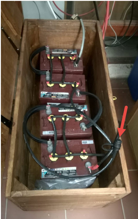

Bought a Trojan watering kit for a client, who decided he does not need it anymore.
Seeing as I have a 24v bank, I never bothered. Last week I decided to install it, even thought it is a 48v kit, I do have a lot of spare parts now.
Where the arrow is, connect the rubber bulb hand pump, pump until there is no more water movement in the pipe, and you are done. Takes less than 2 min, no wastage and no mess.
It is, for me, as close to no-maintenance batteries as can be.
Notes:
I doubled on the pipes between the batteries, just because.
Wooden battery box are on wheels. Got tired moving them around at times. Obviously, as Murphy dictates, since they are on wheels, I have never had to move them.
The black cables between the batteries, are flexible busbar 250amp cables. Got tired of crimping.
