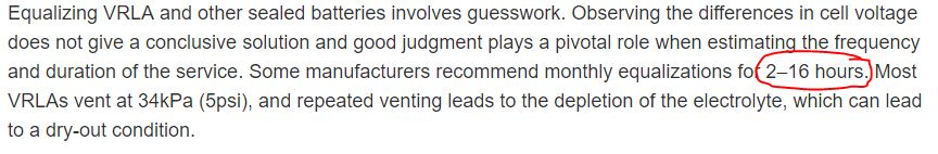

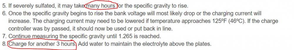

No, the correct answer is you equalize and take specific gravity readings EVERY HOUR until the specific gravity no longer increases and then charge it for another 3 hours. You can Google it. Here are some examples:
What does "DEPENDING ON USE" mean? If you use them on a solar system with solar panels and an inverter, you use them every day, 24/7.
How often to equalize? That  ranges quite a bit.
I would say that your specific gravity tells you when have low or wide ranging specific gravity (>0.030) between cells after fully charging a battery.

It means that my usage dictates I must equalize my Trojans every 6 months if I want. I know this not because Google says so, but because I asked the supplier for MY usage.
Google has a LOT of good answers, but like a Dr will say, Google is not there to replace a Dr. You need to speak to the manufacturer of said batteries, they are the experts on their products for they give you the warranty, not Google.
So spot on, what you quoted above, was from overused batteries trying to get them back into shape = "DEPENDING on USE" - for yes, it can lead to dry-out conditions. :D
