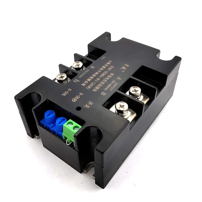

August 15, 20224 yr Greetings good people, Has anyone used one of these cheap Chinese soft starter modules on pump motor running off a solar inverter? The modules are SCR based with adjustable soft-start time and voltage (0-30 seconds, 150-250Vac). There's no integrated bypass contactor. I want to consider using one instead of a VFD to run a 1.5kW (2hp, 10.8A full load current, 35A starting current) single-phase submersible pump off a 5kW Deye hybrid. A photo of such a module with its heatsink is attached. Thank you. Edited August 15, 20224 yr by Kilowatt Power Edit: Remove duplicate picture

August 15, 20224 yr 19 minutes ago, FuzzyBullets said: That soft starter is for 3 phase. Not if you see it only has 4 wires. Not 6 as per the picture below the post. 2 are marked input and 2 output.. This is then wired through to the pump.
August 15, 20224 yr Author 3 hours ago, FuzzyBullets said: Get yourself one of these jojo pumps. Thanks but unfortunately I already have a single phase submersible pump.
August 15, 20224 yr Author 7 hours ago, Scorp007 said: That soft starter is for 3 phase. I'll get a single-phase soft starter like the one below
August 16, 20224 yr Author 17 hours ago, FuzzyBullets said: Should work. I'll give it a go based on the number of positive reviews I've read on AE. Shall definitely feedback after installation.

May 18, 20233 yr Author On 2023/05/16 at 11:41 PM, Jack007 said: Any update on how the soft starter worked? Hello @Jack007. I ended up getting a different series by the same manufacturer. The slightly more advanced version is branded Noker and comes with a built-in bypass contactor, comprehensive motor protection functions and optional Modbus communication. Working like a charm!
