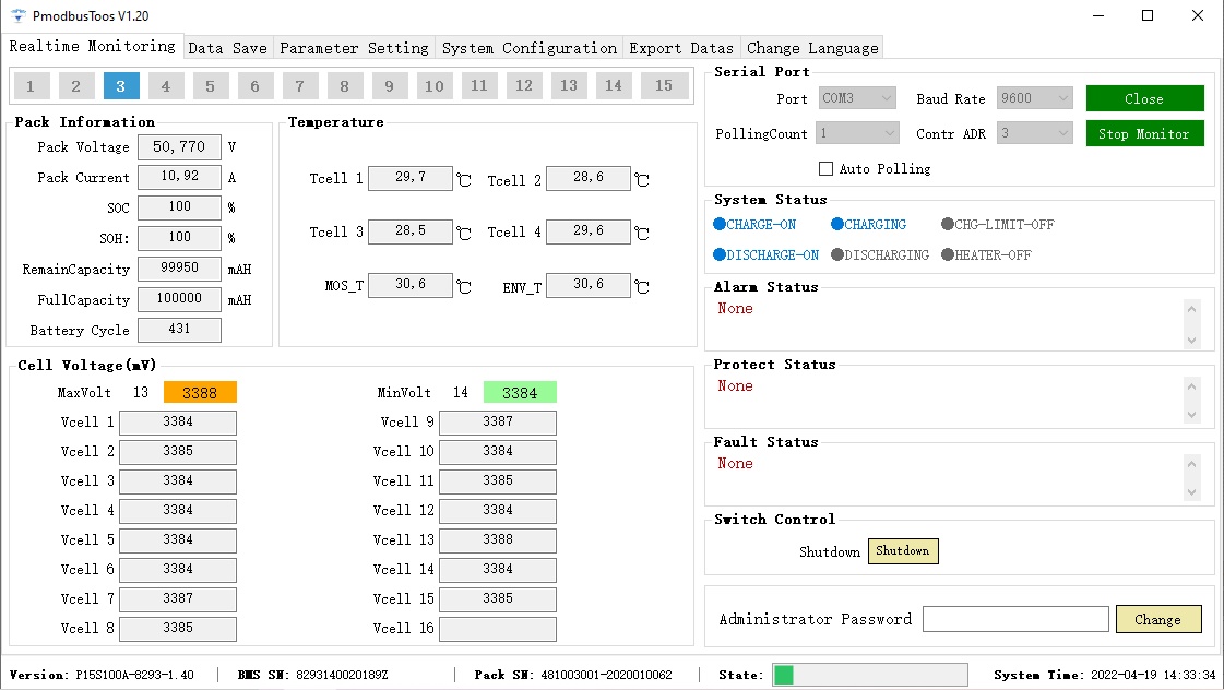

August 23, 20224 yr 5 hours ago, jumper said: Are you able to see individual cell voltages? That depends on your BMS and the corresponding computer software. Actually on the BMS of the Leoch 10048 I can read the individual cell voltages on its own built in display. But it is way more convenient to read them on the computer with corresponding software via i.e. an RS232 or RS485 cable and adapter. See example below:
August 24, 20224 yr Thanks @Beat, that's exactly what I meant, if @MakoSharkcan see something like that he might be able to see which cell/s are low when some are causing the cell over voltage error.
