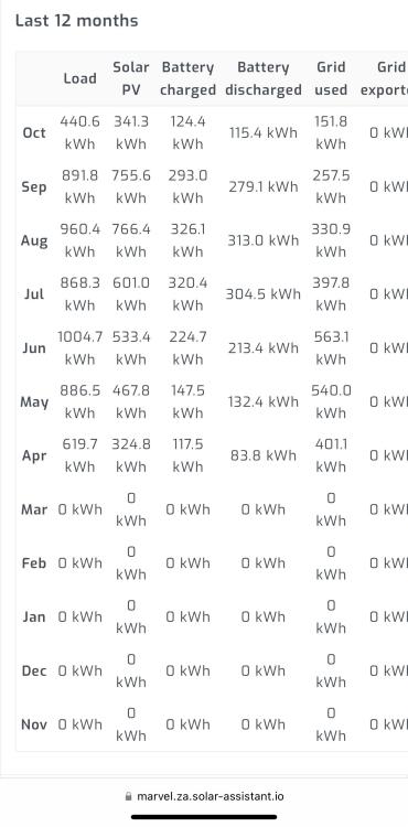

    Hi all...   Thought I'd share my usage stats, system was installed and online from 26 May 2023. System info: 12 x 550w Longi Panels (North Facing) 2 x 5kVa Sunsynk Inverters 1
