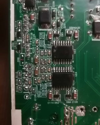

@Coulomb , @JustinSchoeman while on the subject of 3525 PWM based drivers , I have noticed that Voltronics has upgraded to a brand new design for Axpert MKS4 . Could be MKS3 as well but I cannot verify that.
So the new drive for the battery MOSFETS and the DC-DC IGBTS are based on an isolated based Texas Instruments chip called the  UCC21540 . See  https://www.ti.com/product/UCC21540 .  So in essence this is dual isolated  gate driver .  Because this is functionally only a driver  and the 3525 PWM controller does not exist on this board , I assume the DSP now generates the PWM phase outputs to the drivers. I have not traced it  but surely its under DSP control now . Maybe Coulomb can verify that in his firmware resources , if its possible to do so. Because it is isolated , the MKS4 board does away with the 4  pulse transformers altogether.
below is an image of the MKS4 pcb board showing the drivers :
2 chips , giving 4 isolator drivers for the battery full bridge mosfets:
and 2 chips , giving 4 isolator drivers for the dc-dc converter IGBTS's
Pretty cool I think.
Although tempted to trace this circuit , I do not have time , and will wait when I need to repair one before attempting to trace.
EDIT : In general the MKS4 board is very similar to MKS2 , with the dc-dc  drivers being the fundamental change. They also introduce TVS diodes for surge protection as you can see in the images above.
But the rest is very similar , the dc-dc drivers based on T350 remains stock standard.  There are of course subtle differenes , because the MKS4 can deliver 600 more watts(5.6kW) the caps are bigger and mosfets & igbts are rated higher.

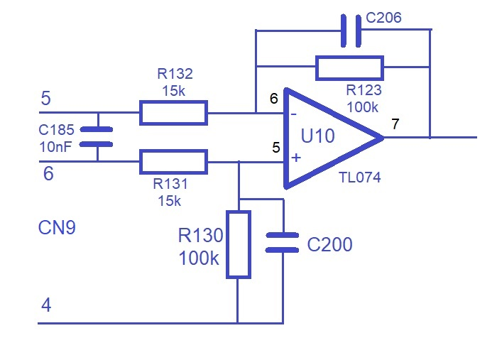

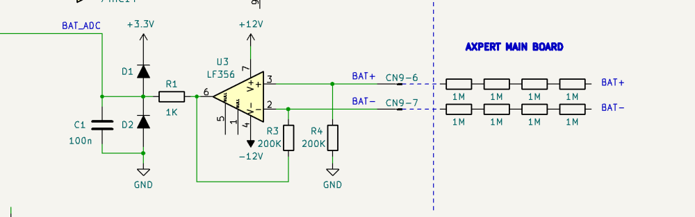

Hi @Coulomb , I have bread-boarded a differential instrumentation amplifier  , as shown below , to read main board battery voltage from my Pi PICO  .  I want to point out that I can now confirm that when the -12V rail supply goes open circuit , or shorted to ground , then the op-amp outputs the maximum positive voltage that the it can drive , in my case it is  about .5 in access of 3v3 clamped by bleeding diodes . This is true for LF356 and a 741 and a TL074 as per DSP . So the CPU shows its maximum  reading and hence we see high values on DSP display , e.g. 120V for battery.  If the +12V rail collapses , the output is 0V.
So as we know by now this is typically due to the input filter capacitors  of the 7912 -12V regulator going dry.
Edited by BritishRacingGreen
I also found this schematic on your repair thread. The resistors R130 and R123 are 100k, so gain is 100k/(4 x 1M)., multiplied by 120V gives an output of 3V, which explains why the 5kW inverter shows  120V batt voltage when - 12V fails.
sir you read  to  your pi pico   not  from  pi PICO    i think its  typo?
Thanks @wael_fathe, your inputs are always welcome on this thread. Yes, English not my first language , but I think you get the drift : the opamp output is connected to an ADC channel input of the Pico.
voltages  unstable and  especially  -12vdc   as  it seems the  12+  willl  cause more  serious problems
Yes, the loss of - 12V  results in a maximum output of the  opamp regardless of any sense voltages from the resistor strings. That causes very high values being displayed on the pico or DSP controller.
The loss of +12V will result in O volt output of the opamp.
In addition, the +12v and - 12v are also used to generate the PWM mosfet and igbt gate drives of the DC-DC converter. The loss of +12V will result in the SG3525A chip not being  powered at all , so there will be no gate drives.  So I dont think the loss of +12v is catastrophical or serious.
