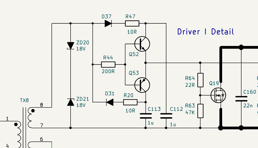

Coulomb , the schematic snippet below refers :
It appears that the circuit built around Q52 and Q53 reshapes (rebuilds) the transformer output signal. D37/C112 and D31/C113  establishes a new positive and negative rail supply , and Q52/Q53 produces a new signal from the rail feeds. Why would this be important for the MOSFET gates , whereas the IGBT gate drives have a very similar drive circuit , but without this Q52/Q53 arrangement.?

@Coulomb and @JustinSchoeman , thank you for your inputs . It has prompted me to investigate a little further .  Yes in the case of the battery side , there are 4 MOSFETS in parallel , and for sure the  net input capacitance of the gates are now 4-fold.  I now believe the totem pole circuit is a re-shaping device , with its major asset being the 1uF storage capacitor in each of  its supply lines.
My assumptions are based on the fact that the FET gate input of the mosfet is in essence a high impedance and therefore  a voltage controlled input. However it also has a relatively high input capacitance , which does bring about current spikes when the gate is switched  .
It is now my theory that the high output impedance of the transformer output is not sufficiently low enough to switch the gate voltage fast enough. So the wave is reshaped , but the 'supply' rails are now augmented with two storage capacitors , one on positive , and one on negative.
When the caps are discharged and the circuit is switched on , the first gate pulses will be poor , as the transformer will have to supply both the gate drive signal and charge the capacitor. But once the short switching time has lapsed , the transformer supply has 'ample time' to charge the cap. Now when the next pulse arrive , we have both the transformer output as well as the charge on the cap in order to combat the gate input capacitance. Again after the switching time , the cap has again ample time to recharge , at the cost of the gate drive having a slightly lower voltage , but still well above the gate threshold for saturation.
I think I have proven my theory after taking an oscillogram of the gate signal versus the capacitor voltage.
The green trace is that of the voltage on the capacitor on the positive rail . Clearly you can see the discharge during gate switching period, and the subsequent replenishing of charge for the balance of the pulse duration.
The same of course will hold true for the negative rail.
This is a shot in the dark , so I welcome your thoughts.
Edited by BritishRacingGreen
That is pretty much it.  There is enough energy in the entire cycle to rapidly charge the gate capacitor. But not enough instantaneous power.
So, D37, R47 and C112 form a filtered power supply. Q52 is a class B amplifier (current amplifier) running from this power supply to supplement the transformer power during the switch on phase. The other components are a mirror for the switch off phase.
The lower currents on the HV side mean that you have to move much less charge to turn the devices on and off, and you can get away with driving directly from the transformer.
The diode and capacitor are the two half-wave power supplies, positive and negative with respect to the MOSFET source. So the only slight mystery is the purpose of the resistors. I now think that they are there just so that the transformer output doesn't get too loaded just charging the capacitors, as well as the gate capacitance. So immediately after switching, the capacitors supply most of the current to charge the gates, and the resistor makes sure that the bases of the bipolar transistors get a high enough voltage to turn on hard. If the resistor wasn't there, the transformer would be loaded charging the capacitor.
I suppose that does amount to reshaping the transformer output signal, so we are actually in agreement.
Yes my term 're-shaping' is probably stretching it (no pun!) , I think a better term will be a buffer amplifier , although its very application-specific.
Yes , there is only one IGBT per drive , so that does make the difference.
Yes , agree , the resistor initially confused me , but I also think its to do with not loading the transformer too much.
Thanks @Coulomb / @JustinSchoeman this exercise for me was super important  in order to document a procedure for identifying acceptable gate drive patterns during debugging. I am going to be honest and direct I did not know IGBT /MOSFETS from a bar of soap really when I started with solar 2 years ago , and what I have learned so far on this forum is awesome. And knowing there will be even more to learn as I progress on this 'journey.

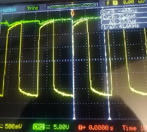

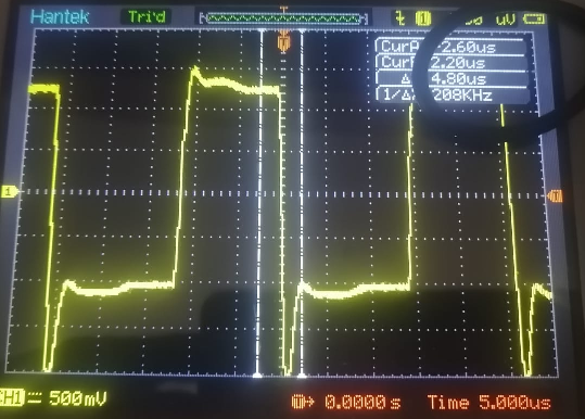

I do have a new question or two regarding the gate drive on the igbts. My scope reading shows switching spikes that goes beyond 20V (max ratings  for these igbts/mosfets) .  as you can see there are protective zeners on the transformer output that is suppose to clamp to 18V + 0.6V = 19V in both positive and negative directions  , which I see as too close for comfort , given tolerances of these zeners. But that is for another day .  Cheers
If this is with the IGBTs in place, then it's very hard to decide whether a spike on the scope is real or not.
If it's without the IGBTs in place, it's still challenging, with fast changing signals everywhere. I find I get the least worst results when using the spring earth contacts to get a really good local earth for the scope probe. Something like this:

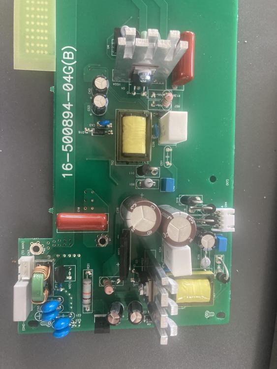

Does anyone have a schematic of the MPPT board shown in the pic . It is from a Kodak OGS 5.6 which I think is an Axpert , OEM by voltronics ?

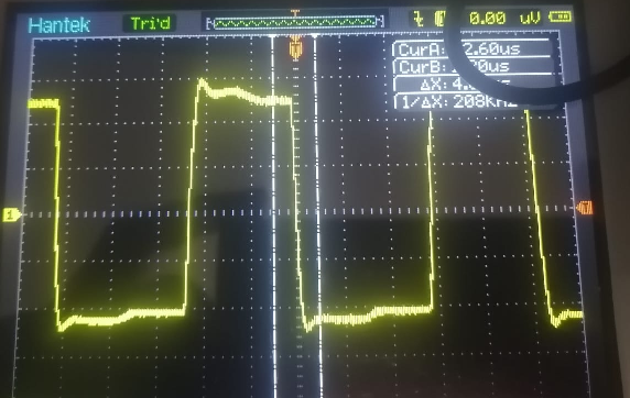

I have drilled down somewhat on this issue .  the 'spike' appears as a short spike , but I  stretched out the signal wider in time ,  the images below refers:
The Y scale is actually 10V per division
It is  not apparent in the image, but the bottom of the spike is actually clipped by the zeners. I have removed one zener , and the spike goes below -20V.
Note that this is with an IGBT fitted , far more damped . If I remove the igbt , the spike oscillation can clearly be seen, as below: please note this is without zener clamping:
and here is the same wave , but zener clamping restored. you can see the shaving at the bottom.
This to me is good news because one can observe the zener clamping on the scope without actually have to remove one to prove its ok.

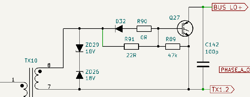

So although the pulse reaches very close or on the +-20V absolute maximum rating of the igbt , the circuit under repair is correct , and I will abide by that. I have performed the same test on two different 5kW machines and they both expose the same waveforms.
EDIT : It is noteworthy to see that when the igbt is fitted , its capacitive load increases the switch off period from 48nS to 960ns.
EDIT2: This data is of course also useful  if we want to check whether  an  alternative / replacement IGBT is suitable in the machine.
Infortunately no schematic or even partial schematic is available.

Excellent work, thanks for that. I'm intrigued by the asymmetry: the positive going edge doesn't seem to want to oscillate / overshoot nearly as much. Maybe there is something on the driver side causing that. Maybe it's as simple as better bypassing of the +12 V rail than the -12 V rail. And/or the +12 V rail being far stiffer, having to generate far more current than the -12 V rail.
Any chance of verifying that hypothesis? Looking for noise on these rails?
Added last sentence.
D32 bypasses the gate resistor for discharge (turn off) - so turn off is faster and less damped. You need to manage dI/dt during turn on, which is why you have R91. Don't have the same problem during turn-off, so bypass R91 with D32 for turn off.

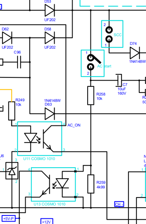

cant see  the  on off  switch on your schematics ?  if it is  really  exists  can you show me how  actually
cpu  senses  the off on  status  and make  a  judgemnt of    black  out or not to black out
The power switch is the one marked "AC start". Opto U13 communicates the state of the switch to the DSP (CPU).
Note that turning the switch on only has an effect on the power supply momentarily; as soon as capacitor C7 charges, there is no effect. But by then the power supply will have started, and the 15 V power supply will be supplying U10, the main power supply chip.
Note that in this model, the SCC (Solar Charge Controller) has a separate switch (actually an opto coupler) that allows  the SCC to start the main power supply even though the switch is off.
@Coulomb , @JustinSchoeman   :  ok  on Justin's suggestion that it could be caused by the gate discharge 0R resistor via steering diode , I took the liberty of removing the the 0R resistor , and ,yes, that's the cause of the 'spike' .
Below is pulse capture with the standard circuit :
And here is the capture of the 0R resistor removed, leaving the gate driver with only the main 22R resistor
Now its pretty symmetrical.
I have learned via google search that IGBT has typically a slower turn off time in relation to turn on , and in relation to mosfets. Probably the reason for the heavier gate discharge needed when turning off , and hence the steered 0R resistor.
EDIT : I have finally decided that if I want to maintain the repairing 'journey' , then a SMD rework station is a must . So this week I purchased one as an early Christmas present ! Its a generic Chinese model , but it just works for me .  It has a fan for blowing hot air  , instead of a piston pump as per expensive models , but still very impressed. I have removed the 0R resistor literally within seconds , and replaced it in seconds . Should have done this when I started repairing. But so we learn.
Thats impressive, repacing 0R resistor solved the issue.
Edited by tanveerhabib
Hi @tanveerhabib , thanks , but we have not provided a fix here per se, I have only proved why there is a a short period of damped oscillation on the negative going switching of the driver circuit. But the OR resistor has been restored , as its primary function is actually to improve the slew rate of the pulse when the driver is switched off.
