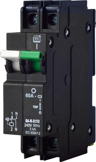

The wiring in this house is dodgy as hell. I do not know how a CoC was issued when I purchased. I checked the DB now and The is only 1 live and neutral going to the main switch (separate from the DB) and the same to the main switch on the DB. If I put either off everything is off. My main switch is similar to this but 63A.
Main Switch CBI ELECTRIC 60Amp

3 hours ago, Bobster. said:
What if the total load in the property could exceed 60A (the limit in Johannesburg)? Would you then apportion the loads across phases so that you don't exceed 60A per phase.
Thats what I mean. If you have three phases available, then you try and balance across the phases. Some loads on the red, some on the white, some on the blue. Thats typical. You typically wouldnt max out the red before starting to load the white, although common sense isnt that common so anything is possible of course.
Curious, why did you say the property is on three phase power? If the incomer breaker isnt three phase? Or its terminating all three phases from outside but only connecting one of the phases to your loads?
I know the supply to the houses in the area is 3 phase.
