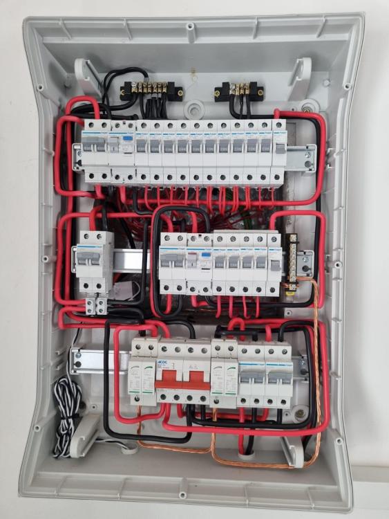

July 23, 20233 yr One of my installations of a single split DB in Somerset Edited July 23, 20233 yr by CobusK Just addes description
July 23, 20233 yr 17 minutes ago, CobusK said: One of my installations of a single split DB in Somerset Nice wiring work But what if you need to replace a faulty CT coil 🤪

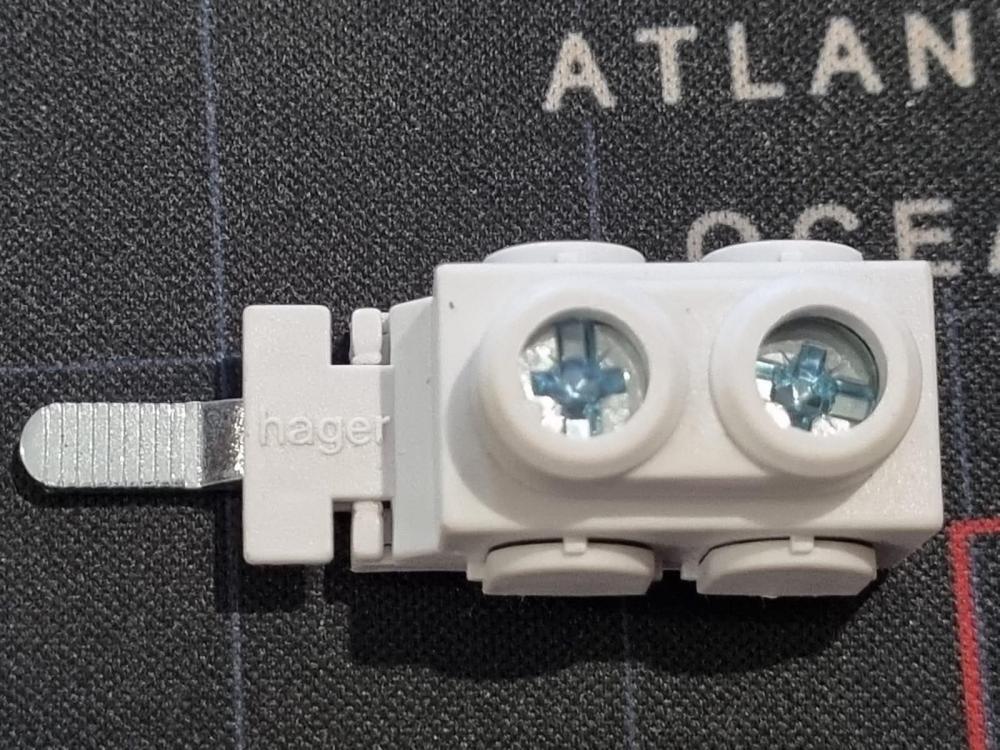

July 23, 20233 yr 2 minutes ago, CobusK said: Easy access behind the main MCB 🙂 My fingers waaayyy toooo fat to get in behind there 🤣 Or is there access from behind?
July 23, 20233 yr 9 minutes ago, CobusK said: Easy access behind the main MCB 🙂 I cannot find these connectors anywhere, where do you get yours?
July 24, 20233 yr 12 hours ago, WannabeSolarSparky said: My fingers waaayyy toooo fat to get in behind there 🤣 Or is there access from behind? 🙂 Depth behind is forgiving
July 24, 20233 yr 5 minutes ago, CobusK said: Hager product, I found them at Frontline in Somerset Thank You

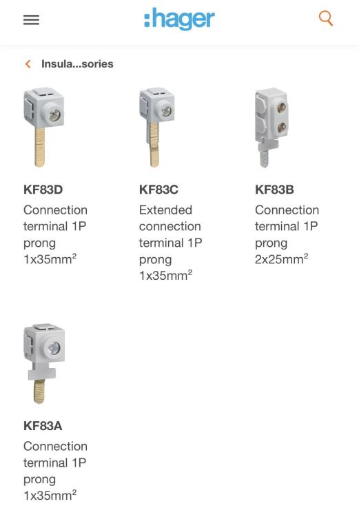

July 29, 20233 yr On 2023/07/24 at 9:37 AM, CobusK said: Hager product, I found them at Frontline in Somerset Can you please tell us the exact name or model no.?
July 29, 20233 yr 4 hours ago, PowerUser said: Can you please tell us the exact name or model no.? Hi, sorry there is no model number on this product. There are two types of these terminals. This one with connecting wires perpendicular to the prong whilst the other is a linear connection. It accepts 16sq.mm wire
July 29, 20233 yr 4 hours ago, CobusK said: Hi, sorry there is no model number on this product. There are two types of these terminals. This one with connecting wires perpendicular to the prong whilst the other is a linear connection. It accepts 16sq.mm wire Thank you! Found them in the Hager catalog:
