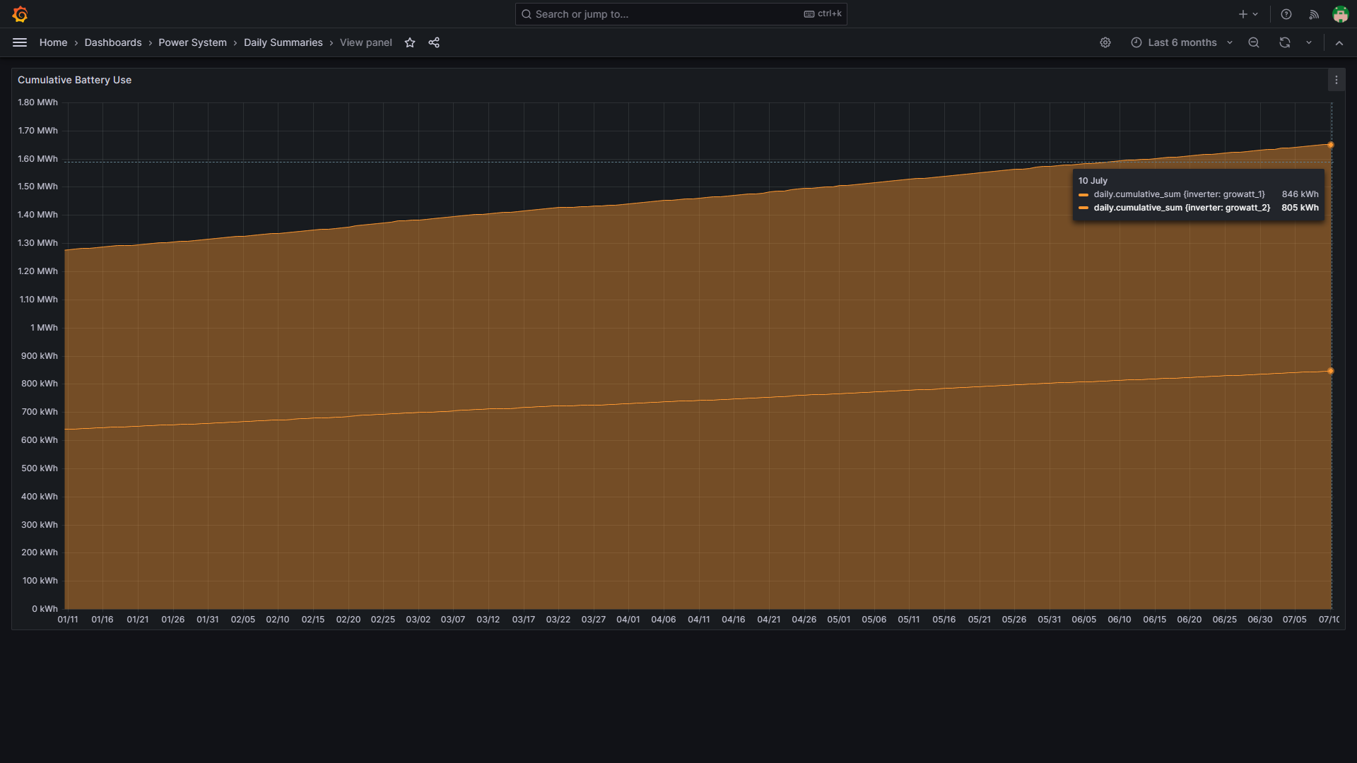

@jumper Agree with you 100% they should have changed the parameter on the Seplos battery BMS to 90%, easy thing to do, I know it can be done if you install the Seplos software, I just don't want to do it, it may have some implications regarding the OEM guarantee. regarding the 10 years guarantee, I did not ask about the 80% capacity. Anyway, I am archiving all the info from the battery in case there is a dispute on the guarantee, I've never exceeded any of the OEM parameters. So far almost 2 years of using the battery and used about 1.6 MW of power the battery still performing within my expectations. See dashboard
