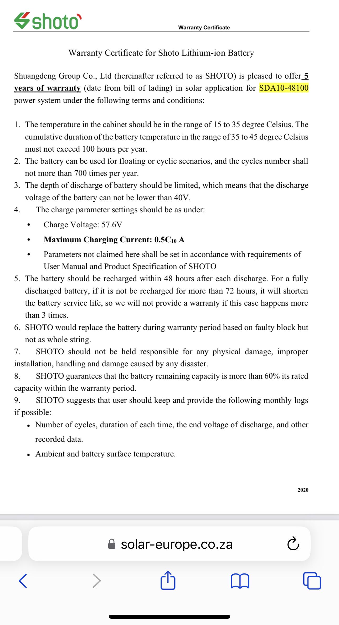

July 8, 20233 yr Author @Steve87Wow that helps. That you so much it really puts things into perspective. I have 3x SHOTO SDC-10 box 5 batteries 48v.

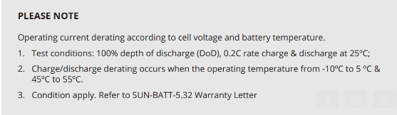

July 8, 20233 yr @Steve87 I sent Sunsynk an email and logged a call on their website lasy week asking them for the Sun-Batt-5.32 warranty letter that it talks about in the battery brochure as I can find no sign of it on their website and I can't find anything confirming what % life they actually guarantee. Most of the suppliers seem to be rather "vague" about what capacity they are actually guaranteeing for 5 years and what is actually classified as a "cycle" i.e. is discharging the battery to 95% and then recharging it back to 100% classified the same as discharging to 20% and then back to 100%? Edited July 8, 20233 yr by Sc00bs

July 8, 20233 yr The most updated Warranty document. They are not vague at all. It's all very well described.

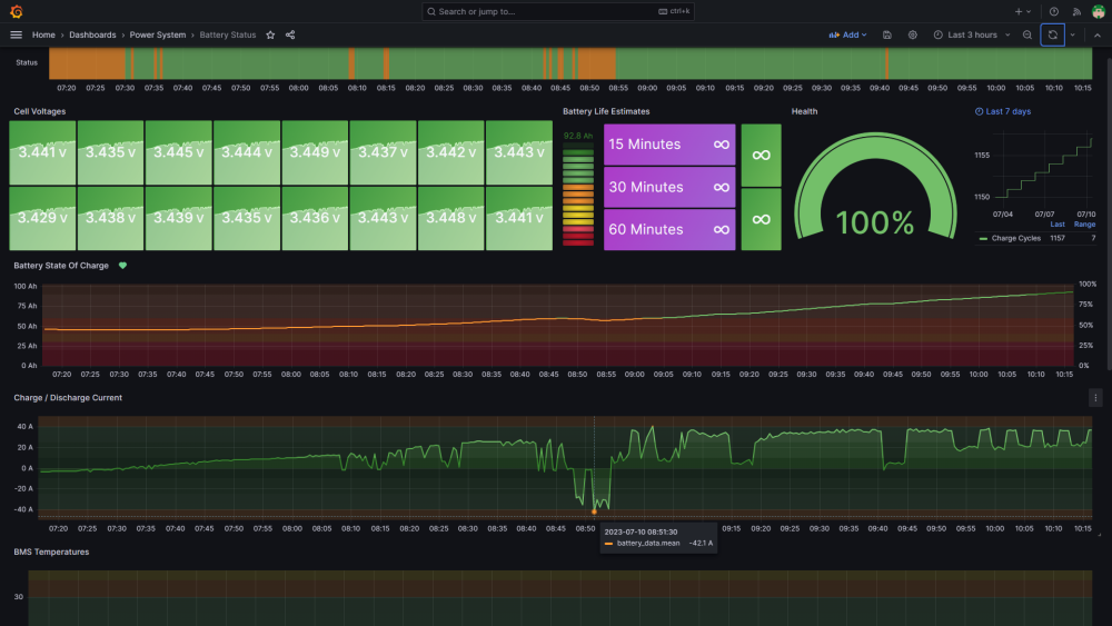

July 10, 20233 yr 16 hours ago, Raiden2912 said: So one more thing if you cycle your batteries down to 30% daily. That’s 8 hours which theoretically means 8 or 16 cycles. So if SA is reporting a certain number of cycles if you divide that number by 8 or 16 you would get your true cycle number? Is my calculations off here. The easiest way is to just divide by 4 to get the 'real' cycles at 80% DOD as it counts every 20% instead of 80%. I also use about 30% daily (from 1 battery) and changed my parameter to 90%, so I get 2-3 cycles per week. This is after almost 1 year of service:

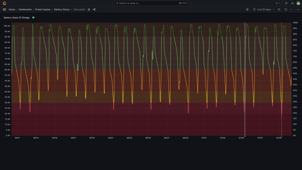

July 10, 20233 yr 8 minutes ago, jumper said: The easiest way is to just divide by 4 to get the 'real' cycles at 80% DOD as it counts every 20% instead of 80%. I also use about 30% daily (from 1 battery) and changed my parameter to 90%, so I get 2-3 cycles per week. This is after almost 1 year of service: I stopped worrying about cycle count, also have a battery with a Seplos BMS, as an example see last 30 days dashboard, only once did my battery gone bellow 20% DOD yet it counts one cycle every single day,
July 10, 20233 yr 18 minutes ago, Antonio de Sa said: I stopped worrying about cycle count, also have a battery with a Seplos BMS, as an example see last 30 days dashboard, only once did my battery gone bellow 20% DOD yet it counts one cycle every single day, Yeah, cycle count will probably only be an issue in case of warranty claims. I can see down the line, people being told things like "That's normal for a battery with so many cycles to be broken/ not performing / have damaged cells/ less capacity etc. etc.... you'll have to buy a new one." I think it's important for people to know that the cycle count is 4 times higher than it should be... forewarned is forearmed. Another thing I have read is that the pylontech for example uses the cycle count to calculate and automatically decrease the SOH value and you can see the implications there if it was counting 4x faster. I don't know if the seplos also uses the cycle count for SOH, I've not looked that deeply into it yet.
