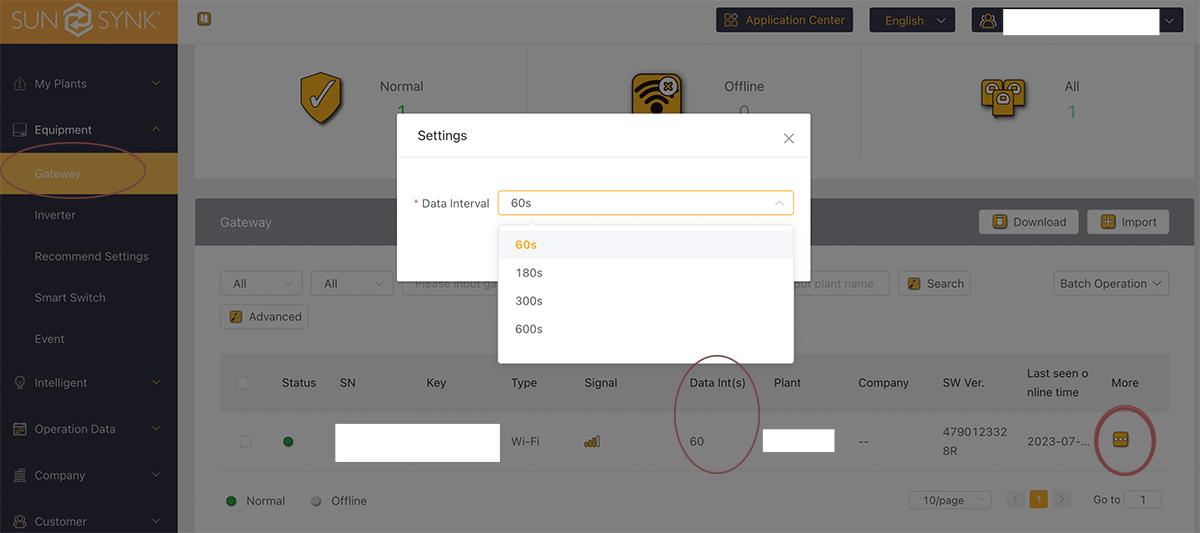

July 24, 20233 yr 1 hour ago, Kalahari Cruiser said: You can change that to a 1-minute interval, which results in much more accurate and smooth charts. I didn’t know this. How?
July 24, 20233 yr Via sunsynk.net /. -> Gateway. Click on More / Settings and chose time interval for refresh
July 24, 20233 yr Thank you. 12 minutes ago, Kalahari Cruiser said: Via sunsynk.net /. -> Gateway. Click on More / Settings and chose time interval for refresh
