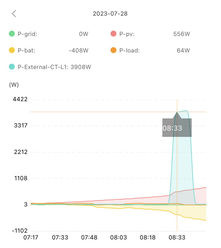

I did some playing around with the app last night, and found the metric “P-External-CT-L1“.  This seems to show all power coming in from the grid, including my non essentials as I can see spikes of 4kw that I assume is my geyser.
Great, same here. When I switch back to 'limit to load' (ie cutting out the non-essentials from solar, and on the main display stat), the P-External-CT-L1 still shows the full grid draw (have tested with geyser) when this parameter is included. Would be nice if the main app display/overview also differentiated between the two at the grid icon, or if the layout allowed some customisation - I know the inverter display has much more differentiation. I suppose SA etc. can do all of that.

CT is installed correctly. The issue isn't about not seeing non-essential loads, more that it didn't appear in the general stats / diagram overview (on app) when set to "limit to load". I suppose there's some logic behind it.
Perfect , yes - that seems to be my understanding as well.
Just did a test where I disabled 'limited to load' and turned on my oven. I saw a 3kw spike on my load on the inverter itself (still waiting on the app to update). So that all seems to be working as intended. It seems the inverter/app default display is 'blind' to non essential loads and it needs to be inferred from the P-External-CT-L1 metric. So it seems like now I will have to manually tick and untick the limit to load depending on my PV and my battery situation.
So it seems - thanks for the P-External-CT-L1 headsup, i hadn't added that as my preferred charting metrics and nice that it's included there at least (I'd still prefer it on the main display).

So the "Load" figure on the graphs shows all the load that your Inverter is configured to support. When you set "Limit to Load" then "Load" only shows essential load - because that's what you asked for. When you set "Limit to Home" then "Load" includes non-essential load - again because that's what you asked for.
But I understand your frustration - It would be great to be able to see the essential AND non-essential load shown separately, rather than just lumped together.
Look at this post where I explained my solution using a custom graph inthe Sunsynk monitoring system.
TLDR: look at the values for P-L1. That is the power flowing across the Inverter's "GRID" port.  Positive means power from grid entering the inverter. Negative means the Inverter is pushing power out to the non-essential loads.
