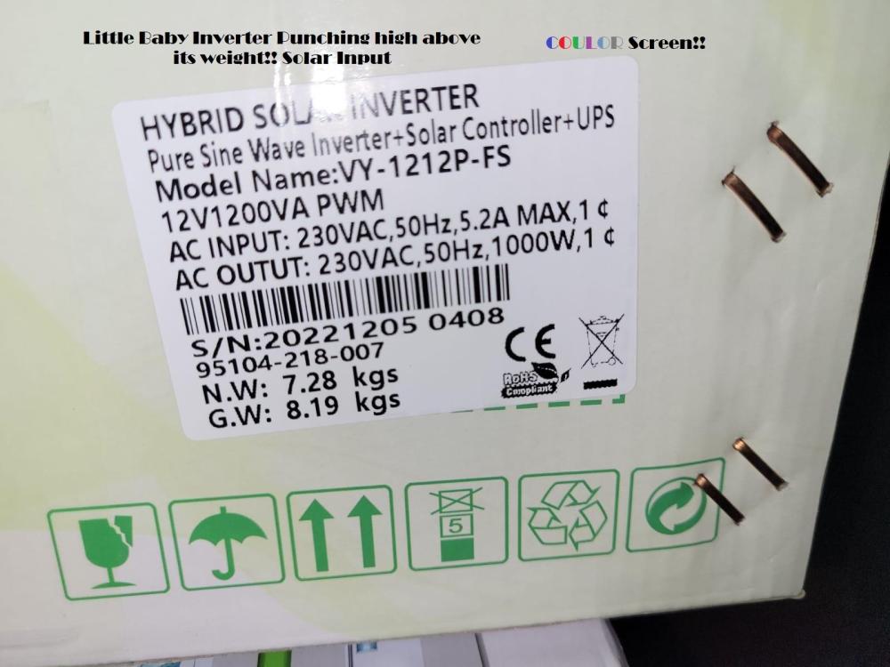

August 16, 20233 yr I have used a few 1kW Fivestar PWM Solar inverters (Soltech) ones, the are very good. 800W solar input. And quiet. They retail for about R3250 of sometimes even less. or (MUST 1kW also option) And a Gel battery in budget (Goldshine at china malls etc. actually good batteries although the chinese name suggests otherwise), then R5500. Will have a very nice little setup with solar. Aslo you CAN set cutoff voltages to protect the GEL battery! Or a "UPS" type like Sunmagic build in charger .battery and cheapie solar controller. Edited August 16, 20233 yr by jlr
