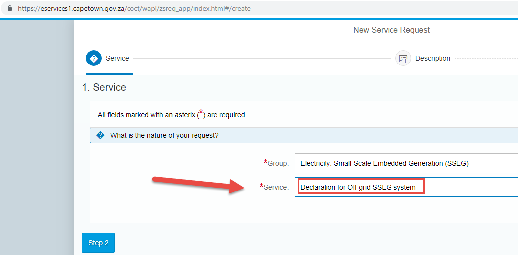

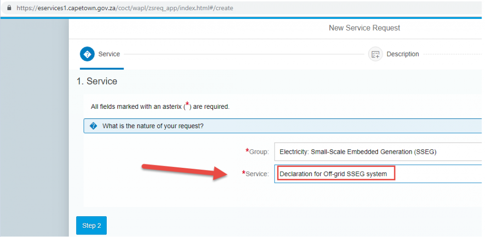

The wording on CoCT website clearly states that they must give authorisation for off-grid systems
I have emailed them. Lets see what they say back, changing from DECLARING to Authorisation.
See the eService is still DECLARING:
