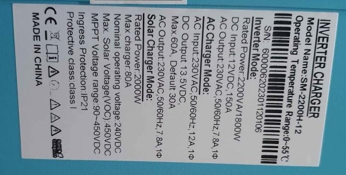

Would the attached pure sine inverter be a better option? The efficiency of kva vs kw also seems better...
KVA is always higher and not much to read as far as efficiency. A lot of manufacturers quote both the same.

This inverter has a higher charge current so will be able to charge the battery quicker between loadshedding which is always a win - especially when we hit stage 6+
12v 100AH battery is 1200WH (1.2KWH). If we work on an 80% Depth of Discharge that gives you 960WH (0.96KWH) before the battery is dead. This does not take efficiency into consideration.
So if you were to have a load of 960W, then a single 12v 100AH battery would last 1 hours.
If you were to have half the load, so 480W then a single 12v 100AH battery would last 2 hours.
This could help you work out what sort of battery capacity will be required. Keeping in mind that a 24V 100AH battery is roughly double the price of a 12V 100AH battery, it also offer double the capacity. 24v x 100AH = 2400W (2.4KWH)
For larger load, higher voltage is "better" or perhaps easier as you do not need to draw as much current and can therefore get away with thinner cables and lower current (amps).
Your AVR and active sub could quickly drain the battery as well. Chances are the amps are Class D or another high efficiency topology, although if they are Class AB like my big subwoofer amp then they will draw a significant amount of power while sitting idle.
Class AB amp rated for 100W continuous would consume around 25W while idle, 500W continuous would be 125W while idle. Until you upgrade to a larger inverter and bigger batteries it may be best to settle for your TV speakers during loadshedding - I have had to give up my speakers and subwoofer during loadshedding as I have been using a Mecer 12v Trolley inverter and during loadshedding I use a bluetooth speaker (I have a media PC, everything plays through there and with my setup its a mission to use my TV speakers).
It looks OK but try and get a manual before you buy. The DC for charging from AC given as 13.5V looks a bit low for charging lithium. Check in the manual that it can be set to at least 14.2V.
Wouldn't the lower charging voltage increase the life of the battery? I don't need fast charging, just charging that doesn't decrease the life of the batteries
No for lead acid and constant charging 13.5V would be fine to extend life but even lead acids need to be fully charged on a regular basis.
Charging a lithium only to 13.5V you might end up with only about 70% capacity. Quite a waste to not be able to use 30%. Also this level will have a big effect on the time taken to recharge.
Charging at say 10A @ 13V you only putting back 520Wh in 4 hrs. If you used more than this during LS then you have less power for the next LS cycle. After a few days your battery has very little to provide power to loads.
Sorry i deleted previous post to much info🫣Basically lfp charge cc/cv charge regime 14.4 to 14.6v.   Cv after reaching the target voltage the charger maintains a constant voltage between 14.4 and 14.6v while decreasing the current until very little current flow indicating the battery is fully charged.

wait...so 13.5vdc means that I will not fully charge my 12v 100ah Lithium battery??
If I only use 70% capacity, then it's definitely a waste!!

Just Google some spec sheets on 12V lithium and refer to the charge voltage for Hubble, Revov and some other known makes.
May be consider your budget to over the indicated R10th level.

thanks, found the chart...
