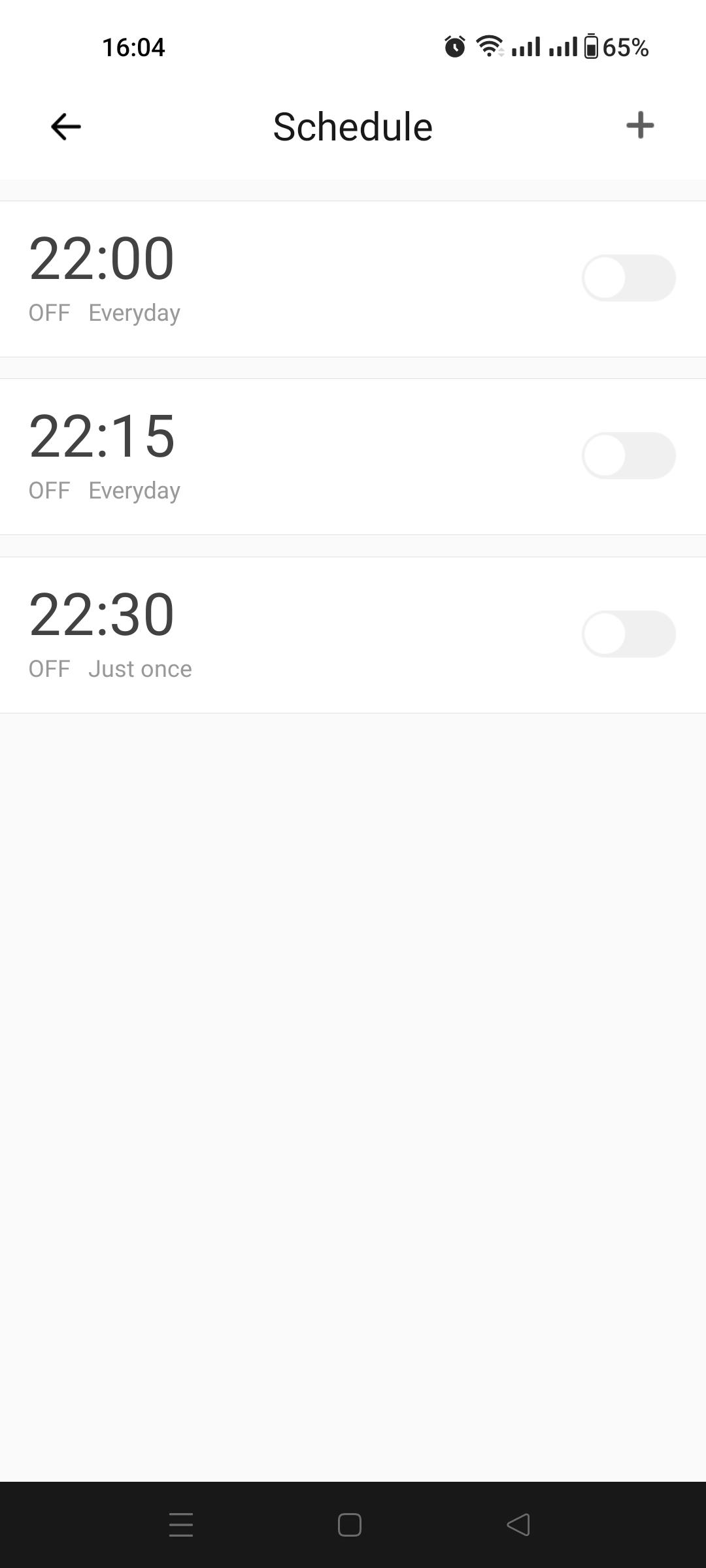

The only way I can think of getting it to be on when you want it and off when you don't with eWeLink only is to set multiple "off" schedules at various intervals. That way if there is loadshedding at night and the power comes back at say 10.30pm, the scene will be triggered to turn the pool pump & geyser on but then let's say every 15 minutes you have a schedule running to turn them off.
Something like this, but you keep adding them throughout the time you you do not want the pool pump & geyser to be running. That way, worst case, it will run for a maximum of 15 minutes only.
Screenshot_2023-09-01-16-04-58-41_41b172fd405cd4f56cfde6a38027ffd1.thumb.jpg.d9409a0540d347cbccb7d046c2b2818d.jpg
There may be a better way to do it (I hope there is), but I cannot think of how at the moment with eWeLink alone.
