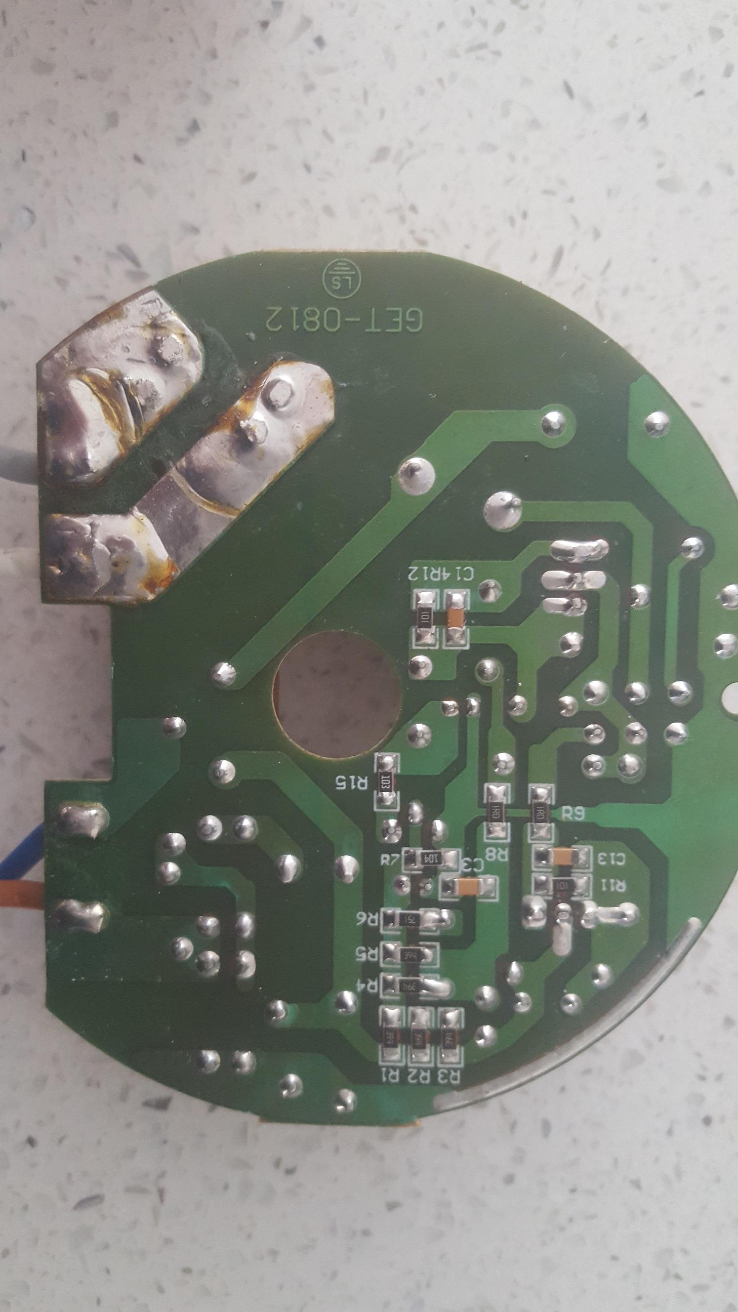

Morning,
The weirdest thing happened, one of my lights blew the transformer... Model GET-0812
Output is AC11.5V 160W.
I stripped the light, (what a job) and found this part completely blow away.
What would have caused this, oh and the isolator switch tripped as well.

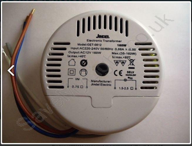

What is the rated input voltage of this device. And where is the step down transformer. Please take a picture of the complete circuit? Is this the light or the transformer?
You are refering to this transformer?

I am confused. You say the transformer blew but you had stripped the light and found the fuse blown. Can you please take a picture of the complete circuit. I just want to confirm something.
pictures uploaded, its a fuse inside the transformer..
The casing states Max. 35 - 160W.
I have 8 x 12 LED bulbs on this light.
ps, I have 3 such lights, the other 2 are ok. so far...
1 minute ago, Antony said:
transformer
That looks like a cheap SMPS to me (switch mode power supply). The power comes in and goes through a fuse and then 4 x 1N4007 diodes (rated at 1Amp each), so very clearly it's taking it to DC first. There is a varistor across it in that area (RV1?), which is a surge suppression device. It is difficult to say, but it looks like it is wired in such a way that if RV1 breaks down it will blow the fuse (as it did).
Cheap SMPSes blow all the time. This might just be bad luck. I have boxes full of these things...
Firstly what is the total wattage of the LED's? the minimum wattage you can connect to this transformer is 35Watt
Secondly, The output is 12 Volt Ac and the LED's normally operate on DC, please check the input requirements for the LED light , This is an Electronic Transformer, dont you see some flickering in the lights?
