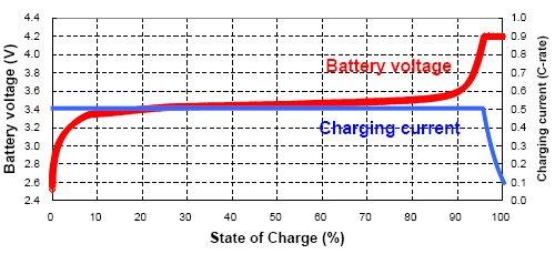

@PylonHV,
based on what @Tinbum pointed-out....are you able to bring all the 6 packs to 3,5V per cell when fully charged?
Why:
  • 3.5V indicates that a LFP cell is almost 100% charged.
  • Contrary, 3.4V can be anyhing from 20 to 80%.

The BMS has a Linear Charge Curve and Right at the top of the charging curve is where the Imbalance occurs and the batteries are UnBalanced with cell voltages of 3.5V (vs) 3.4V, thus UnBalancing  by more than 100milli Volts.
The BMS then Re-Balances all the Packs to around 3.4V and 3.3V with a State of Charge at 100% (50ah), but the modules which were Un-Balanced at the Top and then Re-Balanced by BMS, these are the Same Modules which Drop the Charge at or Below 45% SOC.

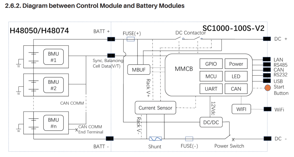

I know HV and LV are different but the cells are the same and i believe both are 15 cell.
to your question
11 minutes ago, Tinbum said:
The HV will have a BMS in each pack.
Thanks for the info!
Yes you are correct, each module has 15 cells.
Can you kindly inform if an external charger is connected to Individual Batt. Module, how to monitor individual Cell Voltage, so that None of the Cells are Charged above 3.5V to 3.6V?
Cells can be monitored with Battery View, however that works when a Minimum of 3 Modules are connected.

Well, each H48050 is able to work standalone and you can monitor it via it's RS232 console port.
Even now, when you have H48050 in the stack, you can plug a console cable into an individual brick.
On the other hand - charging 50Ah pack with a bench power supply running for days at 3Amps is not an easy task. Do you have enough experience with that?
If you do, go on. If not, just ask hire somebody experienced to come onsite and do this for you.
You don't want ruin batteries that are almost new...and/or kill yourself in the process.

If we take the example of individual cells, the problem starts when one of the cells reaches or crosses 3.5V, the BMS continues to supply this cell (instead of cutting it off) while the lagging cell can be at 3.4V. Ideally the BMS should supply the lagging cell to bring it up to the leading cell, instead the cut off for the leading cell is set at 3.6V and that is where the mismatch is created and Top End Balancing is Not Properly Performed by the main BMS or the BMU of the individual module (Not sure which one is it?).
Finally the BMS Balances all the cells to around 3.4V, but during discharge the same module which had around 100milliVolt difference at top end will drop the charge.
The whole idea of charging individual Module is so that all the cells can settle at 3.5V, how to perform this task safely and efficiently is any one's guess?
As you had Access to the Pylontech Manual where they mention to fully charge the Battery, is there any way (published or otherwise) to know exactly what do they Technically Mean by this?
The manual was just one I found online using Google. You will have to ask Pylontech. I only have LV batteries so can't test.
If the cells are the same as the LV, which I'm sure they will be, then they have a charge voltage 53.2v set by the bms, that would be 3.546v per cell. The LV batteries cell balance at anything over 30ma imbalance, if I remember correctly, but the actual balance current is very small, miliamps. It can therefore take a long time for cell voltages to balance. I doubt very much that the main bms will have anything to do with cell balancing- that will be left to the internal battery bms.
I'm pretty certain the HV battery will be pretty well the same as the LV but the BMS will just have the facility to cope with passing a small amount of current through it to enable the other series batteries to charge when its cells are full. I'm also pretty sure that if you leave all your batteries connected and they have an imbalance they will eventually equalize but it could take a very long time.
Again, I would ask Pylontech, I can't give you an answer as I don't know it.. :)

When you say a very long time for cell voltages to balance, can you define any ball park figure i.e. Days, Month or even a Year?
Here again a question comes to mind (having seen the behavior of Pylontech Balancing algorithm), during every charging cycle (if example of individual module is taken) the top end voltages of the cell cross above 3.5V but the bms does not cut off the current till the higher cell reaches 3.6V while the lowest voltage cell also reaches 3.5V, at this point the voltage delta can be 100milliVolts. The balancing is performed afterwards bringing the voltages close to 3.4V. Technically BMS/BMU balances the cells with every charge cycle, however during Discharge the Module which had imbalance at the top are exposed, as these modules drop charge at around 50%.
Why doesn't the BMS cuts power to the highest voltage cell while at the same time charging the lower voltage cell to come upto 3.5V? so that 15cells of the module can be balanced at around 3.5V
You must be right in assuming that both HV & LV would be similar, therefore you have seen the behavior of LV cells and balancing.
