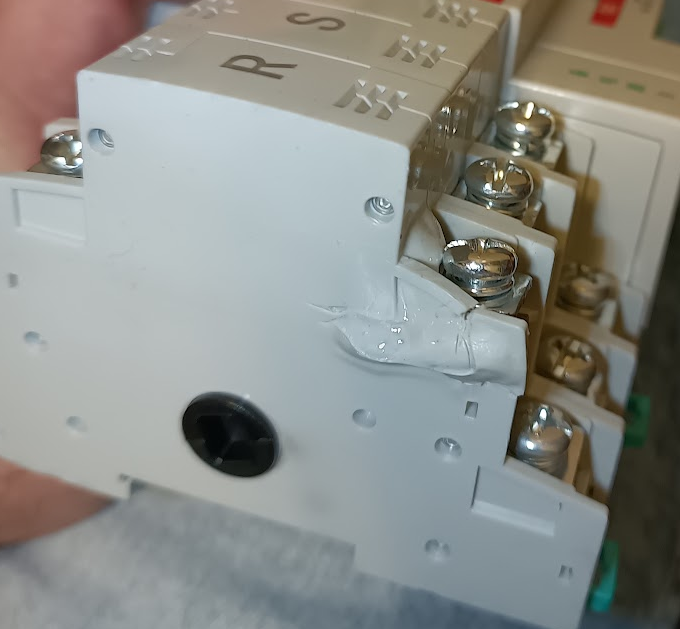

 Automatic Transfer Switch - meltdown
So, after a couple of years one of my ATS melted down. It was rated for 100A Chinese, so I would suggest that it can handle 32A European - well, I was wrong :)
At first I was thinking that the internal contact burned, but after a dissection I found out that there was probably a high resistance on the screw terminal. (See how black is the copper wire under R terminal.) That caused excessive heating and meltdown. In the end, internal contact became so loose and angled that it started to burn too.
As you can see on the first photo, there were 2 wires under each square washer. Wires were stranded, 6mm2 each, with crimped ferrule. The left wire is the input from the grid, the right one is going back to the floor heating that is 2260W (roughly 10A) as it makes no sense to power this from PV during our winters. The same logic applies to S (2430W) and T (2430W) terminals. Terminals on the top are the input from the PV system.
When I tried to remove wires, the ferrule stayed in the spot, as it was welded in the plastic:image.png.38509676a98259037702360adeaac6fc.png
Edited by Youda
Internal contact became angled and burned too:
Two yellow spots on the opposite side of the ATS hit my eye too:
Found out that the cause was the heat from two resistors that have no other purpose than to feed the indication LEDs. That's a sign of imperfect design, I would say:
Anyway, I have two of these ATS in my setup, so I've already ordered a replacement. This time I went for a new version of the product that has better terminals. On the other side, this version is rated for Chinese 63A only, so I am pretty curious what the real ampacity would be :D
Let's see how this will work:
Edited by Youda
Lessons learned:
1) If you have an ATS like this in you system, even though the higher current is just passing over the terminals and not via switched contact, check the terminals from time to time.
2) This type of screw terminals with square washers kinda sucks.
Partial disassembly:
Edited by Youda

I don't see any signs of arc quenching plates in your ATS. Exactly the same as in that Geya you ordered as a replacement. I've tried almost all of them that you can buy on the marketplaces, and here is what i think...
These Geya, Tomzn, EARU ATS's are crap. No matter what brand is printed on the housing, if their shape is the same as in my photos - they're all the same inside. The static contact plates are very thin, the switching contact is made by flattening the core to form contact pads, there is no arc-extinguishing chamber (only a thin toothed plate that can only prevent the case from melting and nothing else). I don't understand how they withstand those 8000 switching operations that is specified in their manual.
The only acceptable quality ones at this moment are ManHua (also sold under other brand, like ZJMNFU on Tao) if you want a 1-phase ATS and a CSQ for a 3-phase setup. I'll attach some internal photos...
The newer ManHua units have a Nuvoton MCU inside them to control the ATS, not just a simple dumb relay - the result is lightning fast switching time, source priority can be set by the switch. Also note the huge arc chamber, the thickness of the contact plates, and the overall quality of the parts...
There are many similar type ATS like that CSQ I've posted here, but some of them does not include arc quenching plates in the models below 100A, like 63A or less (so always order the highest rated unit in the lineup, whether you will be using it at 100A+ or not). I also noticed a strange mounting configuration of the internal A/B source detection microswitches inside some of them, which can cause them to wear out over time easily because they are directly mounted to contact the shaft (last picture, notice the difference of this part in the CSQ).
