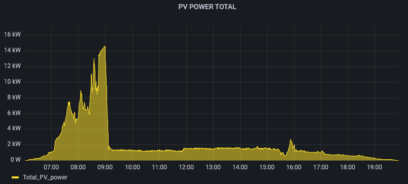

A bit sad thing is, that apart from occasional charging of EVs I have no use for all that power during the summer. Batteries are full way before lunch, water geyser is hot too and therefore the production falls down, just to cover ambient needs of the house:
On the other hand, on the rainy days it's great now. Even if I consume a lot on that particular day, solar is still able to keep-up, power the loads and charge the batteries at the same time:
But what I am really looking for is to see how the new setup will operate during winter. Of course, there still will be a plenty of days with the production nearing zero, but I hope that on the other winter days it might work good-enough.
Let's see!

I looked at crypto mining on my end as my batteries get full around 10 and to burn excess power I let the pool run for 8 hrs now a day. The kit is way too too expensive unfortunately and will take years to break even. Ever since Eth killed it the prices for the other tokens havent been too good to justify an investment. Considering you would mostly mine during sunny hours so 10 hrs at most.
Yeah, the crypto mining is something that I was looking into, but in order to make sense you have to run your gear 24x7, I learned. Otherwise the gear becomes obsolete over the time, as the amount of work needed to calculate each new block is getting higher. Does not make sense to buy 5 000 USD miner(s) and then let them being powered-off half of the time. A friend of mine has 100 kWp on his farm and has racks full of miners running 24x7. What he said to me is, that with this scale, heat and space starts to be the main problem.
