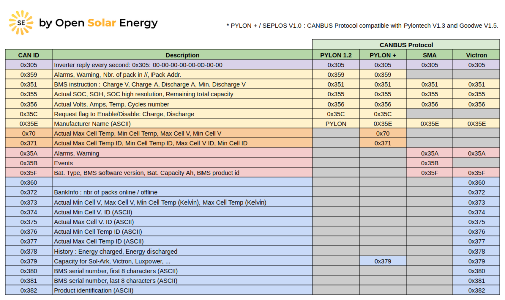

But I'm really baffled as I can't see the 0x70 and 0x371 in the CAN communication. In a document I have showing the CAN protocols they are shown in a different color so I'm wondering if their is something special about them.

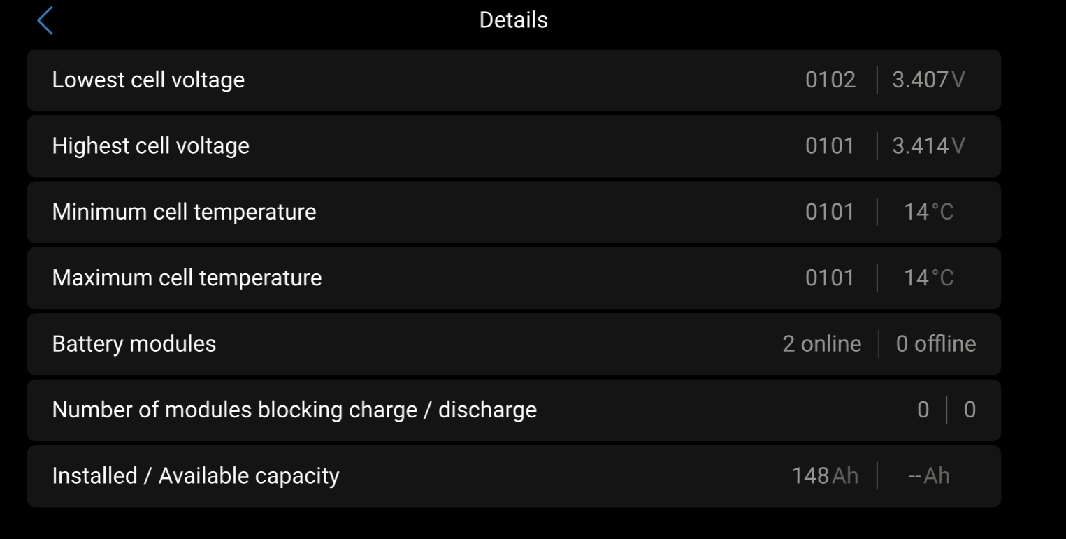

Well, I couldn't wait till tomorrow so turned the pi off and you were right. :) Oh actually it is tomorrow!!
The messages carried on, so yes, the battery is sending them. It's strange though as the CANalyst II sees them but my Teensy doesn't. Their is still no 0x70 or Ox371 anywhere so I think that table may be wrong.
Next I'm going to put the CANalyst II on another pack of batteries, read the messages and see what that shows. Then I will put the Victron Pi on that CAN bus and see if it opens up the battery to 0x372 and above if they were not already being sent. If it is the pi opening it up I will also be able to see what it has sent from it..

I found the problem with the Teensy setup, I had 4 receive mailboxes set as standard and 4 as extended. The 4 as standard were not enough so I added another 4 standard and can now get all the messages.
I can confirm that if you send 0x305 and 0x307 it opens up the 0x372 > onwards. (Tried it on my Teensy instead of the Venus Pi).
I don't know where the 0x70 and 0x371 come from on that chart but I'm sure it's wrong.
0x70 and 0x371 come from the SEPLOS 1.0 document which says to be compatible with PYLON 1.3 and GoodWe 1.5. I had never managed to find the PYLON 1.3 protocol or higher that's why I named this protocol PYLON + in my application YamBMS because I couldn't really put a version number without having had an official document in my hands.
I will now be able to update my code with the PYLON 2.0.5 protocol 😍
As you have discovered you must respond every second with an ID 0x305 what I called the inverter heartbeat in my code.

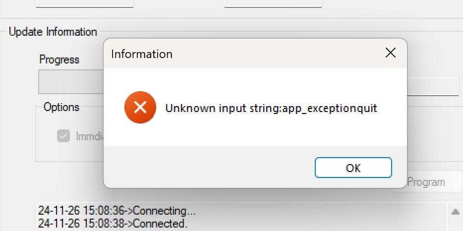

Hey Youda,
I have an issue (and hope that you have some useful hints for me):
My Pylontech did have some strange behaviour, the chargin voltage was kind of jumping.
So my approach was to update the firmware. I followed your instructions and everything was running fine unti about 80% and then I got an error message.  After this the Pylontech Battery was kind of 'dead' I still had some charging voltage on the display of my MultiplusII but no led on the Pylontech was visible.
Then I started your described procedure again. Unfortunately I now get in the last step when turning the Pylontech on with the red button pressed down the error message in the screenshot.
Do you have any idea how to solve ?
