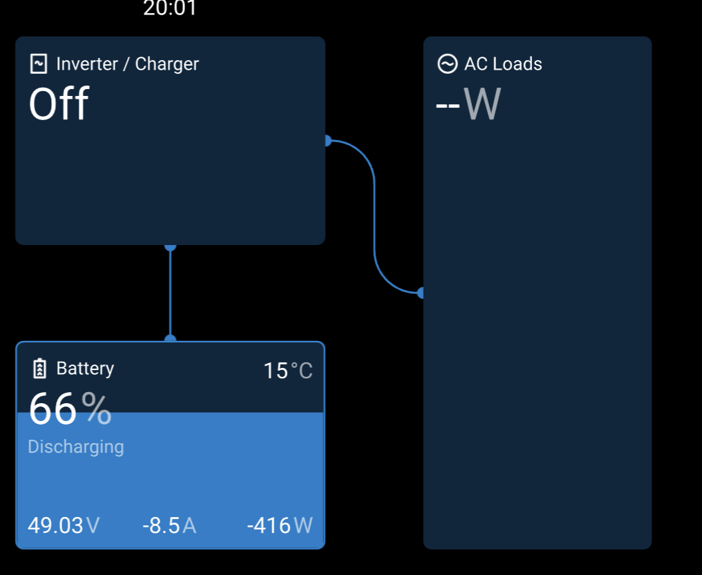

I've been having a look at this and got the Pi set up with Venus and the CAN Hat. For testing I set up a battery emulator and watched the messages.
From the Pi their are 2;
CAN 1   MB: 0  OVERRUN: 1  ID: 0x305  EXT: 0  LEN: 8  DATA:  0x00 0x00 0x00 0x00 0x00 0x00 0x00 0x00
CAN 1   MB: 0  OVERRUN: 1  ID: 0x307  EXT: 0  LEN: 8  DATA:  0x12 0x34 0x56 0x78 0x56 0x49 0x43 0x00
I then tried including the 0x307 data in my actual battery setup but it made no difference.
In my battery emulator I then added 0x70 and 0x371 data to send to the Pi, (little bit of educated guesswork here) ;
    txmsg7.id = 0x371;
    txmsg7.len = 4;
    txmsg7.buf[0] = 0x20;
    txmsg7.buf[1] = 0x0F;
    txmsg7.buf[2] = 0x0E;
    txmsg7.buf[3] = 0x1F;
    can2.write( txmsg7);
    txmsg8.id = 0x70;
    txmsg8.len = 8;
    txmsg8.buf[0] = 0xB4;
    txmsg8.buf[1] = 0x00;
    txmsg8.buf[2] = 0xAA;
    txmsg8.buf[3] = 0x00;
    txmsg8.buf[4] = 0x59;
    txmsg8.buf[5] = 0x01;
    txmsg8.buf[6] = 0x54;
    txmsg8.buf[7] = 0x01;
    can2.write( txmsg8);
I thought it may then activate the following
but no, so I suspect their must be something else. I notice in venus, on the battery details page, their is a place for firmware version and mine is unpopulated.
Edited by Tinbum

·        While the remaining 2 Batt.modules which had initially balanced cell voltages remain at 45% SOC.
Queries:
1.      If the BMS balances all the 45 cells in 3 batt. modules at a specific voltage repeatedly, then why one module drops State of Charge (the one with the initial ImBalanced Cells)?
and it does Not seem to be a problem with one particular module, by hit and trial the UnBalanced module can become balanced and Another module may start to have Unbalanced Cell Voltages.
2.      The basic issue seems to be cell UnBalancing.
3.      During every charging cycle, the cells of one of the Batt module become UnBalanced, but the Pylontech BMS  Balances the cells on daily basis after SOC reaches 100% , however at the next discharge/charging cycle the cells are UnBalanced again? And again the BMS balances all. Why is this so? This has continued for 2 months now.
4.      During Discharge cycle, why the cells become UnBalanced below 45% (SOC) and the battery charge rate drops suddenly if the BMS has balanced the cell during charging cycle?
The overall effect is that the Backup Time of the Battery is Cut by Half.
Solution to the above problem will be highly appreciated.
Have attached a few pictures from Battery View Software here:
Edited by PylonHV
