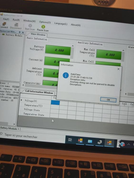

Hello Youda,
I read the various explanations given with great interest.  I just received an update of my pylontech batteries so that my 18 us2kbpl batteries can communicate with the LV-HUB and my three growatt inverters SPF5000 HVM-P in rs485, but my problem I cannot run batteryview  , a message like in the following image will appear and terminate the connection.  Can you help me ?
Thanks in advance.

I have the exact same error now with BatteryView 3.0.17 since my US2000+ Pylons have been updated to v2.4.
However BatteryView 3.0.3 seems to connect just fine.
Also, since v2.4 firmware, BatteryView 3.0.3 has been displaying the incorrect battery amps from the Pylons as well. I don't think its a BatteryView issue more a Pylon firmware problem. I am looking for either a newer firmware or the previous available one.
Any help will be appreciated.

Sorted my issues out.
On 2021/01/30 at 12:37 PM, Bafaro69 said:
Bonjour,
J'ai finalement résolu ce problème de blocage de batteryview avec l'aide d'un ingénieur Informaticien.
What did your IT guy do to resolve the error message. I am experiencing the same using version 3.0.22.
