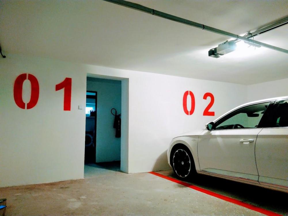

I'm really sorry @Luminous , but there's not much interesting to share. Just everyday's boring stuff.
For example, I had to clearly label the bays in my space-shuttle landing dock, as some (female) family members were not able to clearly understand where they should (NOT) park:
