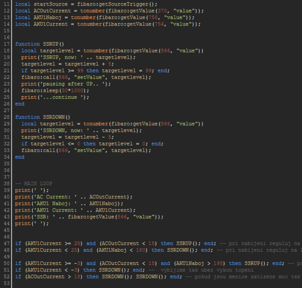

The next part is the circuit with an SSR relay, that will direct "solar energy" into the geyser whenever one of these conditions will be met:
- the battery is full
- the charging current is higher than X amps
The great is, that you can tell the SSR how much power you want to use and it will take care of it using a standard 230V AC phase control. Basically, it's similar to a variable speed capability of an electric drill, for example. The circuit is made of SSR with 0-10V control, EMI filter and 0-10V module (Qubino) that can be wirellesly controlled from my home automation gateway (Fibaro). In the home automation gateway, I have a short script that monitors operating values of the battery and inverters and if there's some spare solar power, it basically adjusts the AC power flowing through the SSR:
There are couple of additional conditions. For example when the AC current draw from both Inverters is too high, I lower the power that's going into the geyser and prioritize the other appliances. Therefore, the full power of invertors is available to any appliance in my LAB, while geyser uses only the "spare power".
The system is fully automatic, but you can monitor it's operation in the dashboard:
This is how the script is searching for how much "spare solar power" is available:
Hot water temperature chart:
So far, it works good ;)

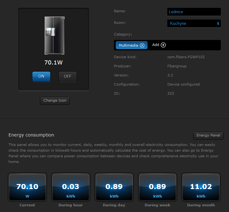

Another example - just by using a simple smart plug, you can monitor daily consumption of your fridge:
The only thing where wireless protocol was not performing well was the solar integration. So after some failures, I went for industrial PLC which talks to Inverter via RS232 and to Fibaro via JSON over ethernet. I'm trying to stay away from Arduino, Raspberry etc. (There are 3 or 4 Arduinos that I use for some specific tasks, but I'm not planning to add more of them.)

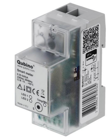

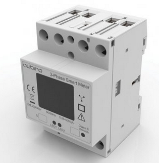

Here is a sample of the stuff that I use as the wireless endpoints:
Qubino, DIN rail 3-phase meter with LCD, 1-phase meter:
image.png.57f753dbfc593424e145dc864e2d8258.pngimage.png.0a9549dd3a24fcbdeb9c4d9b1cc1ebb3.png

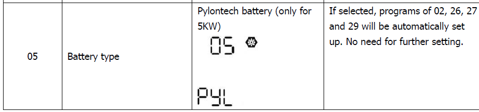

Speaking of PIP, the compatible firmware has a "05 - Pyl" option available in the menu:
Here are the respective PIP user guides, which cover how to configure your PIP for use with the Pylontech battery:
http://www.mppsolar.com/manual/PIP-GK/PIP-GK manual-20190201.pdf
http://www.mppsolar.com/manual/PIP-MK (PF1.0)/PIP-MK manual-20190429.pdf
So, if you do believe that your PIP or MPI Hybrid is a newer 2019 unit and already has a firmware with Pylontech support, but you just miss the cable, then you can create a cable yourself and give it a try.

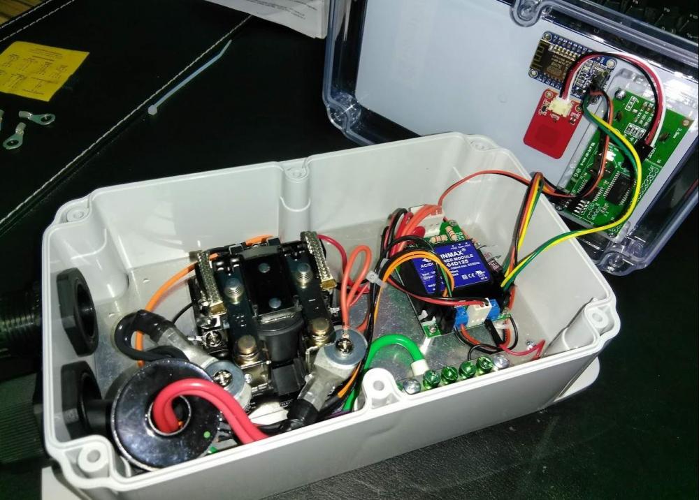

Hi guys,
since there's was not much to do about my solar system these days, I was boring a bit. So I've decided to order a Wallbox for electric vehicles charging. Based on a short research, I've ordered OpenEVSE DYI kit, because it allows to be remote controlled via API. And my plan is to divert the excess solar production into this EVSE, therefore I need a good API to work with ;)
DYI kit just arrived:
Assembling the guts:
Wallbox mounded:
Well, since the Wallbox can draw up to 32Amps at 230V single phase (=cca 7.2 kW), I think that I'll need to upgrade my inverter setup. As of today my two paralleled InfiniSolars have a peak power of 10kW, so upgrade to 15kW sounds like a good move.... stay tuned.
Edited by Youda
Correct.
There are 2 microcontrollers in this box and a lot of periferals😮
  • ESP8266 does Wifi to serial for API and remote controll WebGUI
  • ATmega328 does EVSE pilot signal, relay operation and voltage/current measurement
  • I2C LCD display with RTC board
  • Proximity sensor, instead of a mechanical push-button

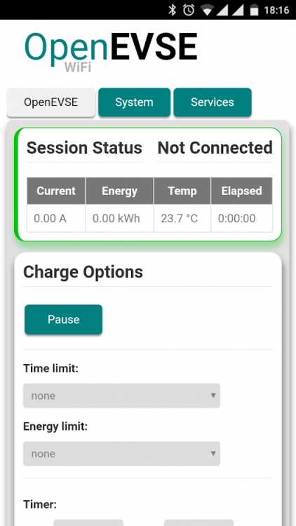

So far, I've been struggling with just one thing: after a day or two, the ESP stops answering to HTTP requests and ping. But as soon as you touch the button on the wallbox, the ESP awakes and everything is okay again.
Maybe that's because I have the unit installed too far from the wifi AP? I have to investigate that more...
WebGUI on the cellphone:
