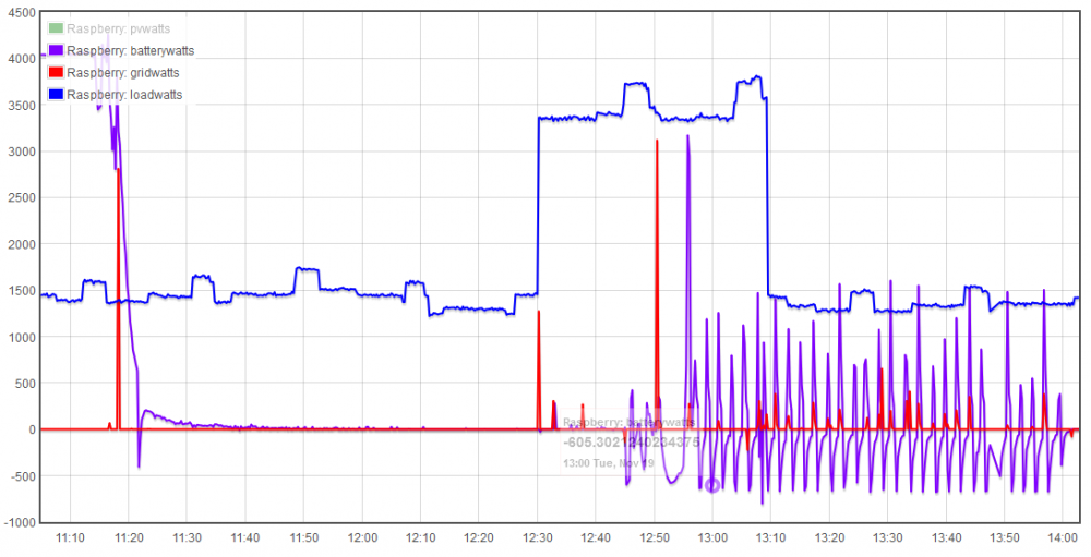

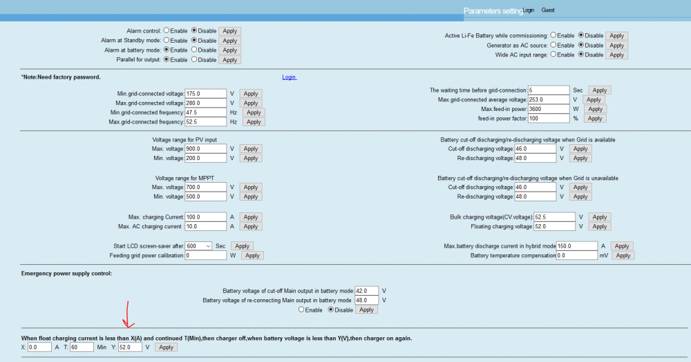

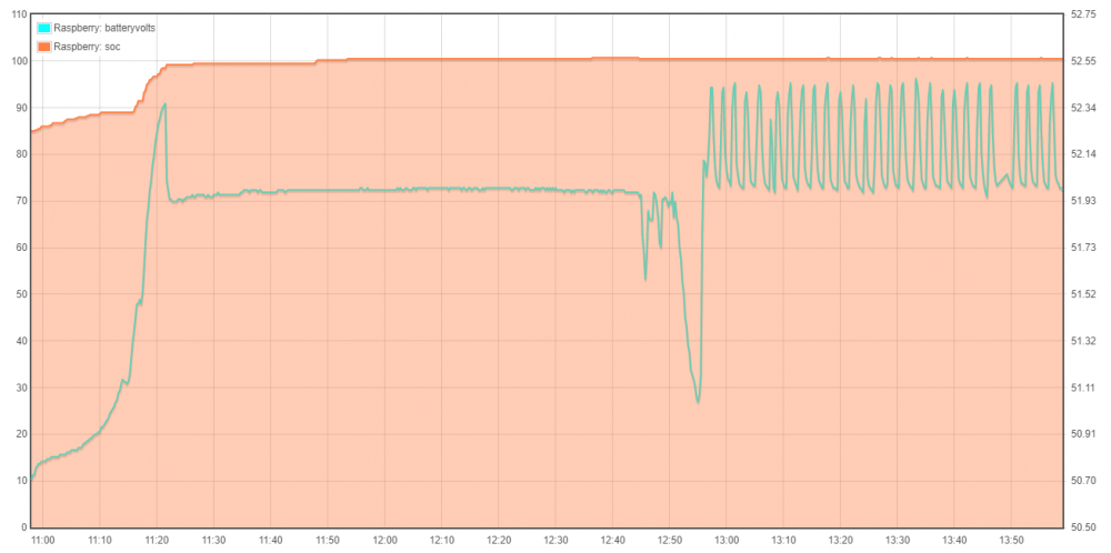

Youda, I followed your suggestion and changed my voltages to:
C.C. = 52.5V
C.V. = 52.0V
Everything worked fine,, and the batteries did the usual "wait at 89%" and then settled at 100% SOC.  We are having a bit of cloudy weather at the moment, and as soon as the batteries had to recharge (after assisting the PV around 12:30) they went into a sort of an oscillation between CC and VC during the recharge after that.
Is this normal after lowering the voltages (they were both set to 53 V before) until the BMS sorts itself out?  I increased "float" up to 52.5 V and it got rid of the up & down bits right away!
@ChristoSnake
you're right - it looks like an oscilation between C.C. and C.V., which is strange as I'm seeing nothing like this on my system. And I have the same type of inverter, too.
Just an idea - don't you have some self-consumption optimization device in your installation? For example geyser that being turned on based the battery voltage, SOC, etc.?
Edited by Youda
Nope - simple installation with no such fancy stuff!
In the mean time I'll retain the lower charge voltages, but keep "bulk" and "float" the same to stop the bouncing.  Just goes to show - no to installations are exactly alike?
I do agree - moving both values to 52.5V will do no harm. Especially if you had C.C.=53V and C.V. = 53V before.
But there must be something going on, since 0.5V drop is not enough to instruct the Infini to repeat CC/CV cycle from the scratch. Just to be sure, pls check the settings of your Inifini for charging rules. Because there might be some setting that was valid for the old 53V setup and now it interferes.
Screenshots attached:
C.C. = 52.5V
C.V. = 52.0V
How do your load and PV watts look like at the same time?
A bit of Ironing at that time maybe?
I am running my 4x Pylontech 's at 52.5V for both CV an CC for the last few months without any issues. It goes to 89% for roughly 30 minutes and then 100%. Because of the inverter (Axpert) slow response on the SCC, the charge (battery) voltage does vary a bit when the sun comes and goes, but SOC stays on 100%. I also get that up and down graph when ironing. Also because of inverters slow response to load changing.
Thanks for all the comments!
Here's a graph plotting inverter load, battery & grid power during the same time.
The spike in the middle (12:30 - 13:10) was a 2kW hot water element turning on (via Geyserwise timer) to give our evening bath water a temperature boost.  Smaller spikes due fridge/freezer motors, and base load mostly swimming pool pump and a few computers.

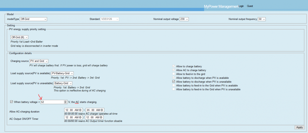

I am not allowing AC charging, only PV.  The time and current based charge is set for <1 A for 60 minutes and <48.6 V, so it should not interfere.  I'll see what it does today with CC = CV, as reference, then try again with CC > CV tomorrow to see if I can reproduce the weird behaviour.
2118267084_Youdasbatterysettings-load.thumb.PNG.b61ab997c63cb605d5bab2eabbe44520.PNGse dangerous "iron" PS:
PS: I notice a lot of comments about "ironing".  I presume that it refers to the dangerous action of applying extreme heat to non-wrinkling fabric for the purpose of prematurely aging the fibers so that you have an excuse to buy new clothes?  I'm glad to report that we do not own any of those evil devices and would never consider taking part in such unnatural rituals :-)

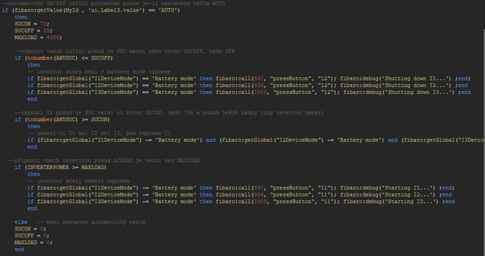

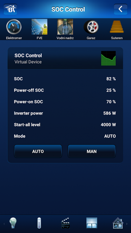

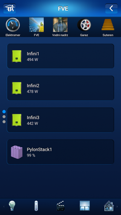

An update from my solar Lab:
As some of you might remember, I'm currently running 3x InfiniSolar 5K combined into a single-phase AC source of 15kW. Most of the year, it's okay, since there's plenty of sunlight and the idle consumption of the three running inverters does not matter. But during winter, it's a completely different story and every watthour, that I'm able to save, is crucial. Therefore, I decided to code a feature that will allow me to run just a single inverter 24x7 and once there's need for a more power, start two other inverters automatically. So, here's the result:
  1. I created a short LUA script in Fibaro, that's constantly checking the AC load.
  2. Normally, just one 5kW inverter is running. Once the AC load goes above 4000W, the script starts other 2 inverters. It takes just a couple of seconds, and 15kW of power is ready to serve the loads.
  3. I've added a safety function, that will turn-off all three inverters once the SOC of the Pylontech stack falls bellow 25%. Once this happens, there's an ATS that will automatically switch all the house circuits to "ESKOM".
  4. Later, if all the inverters are OFF and SOC goes above 70%, then the script starts 1st InfiniSolar and the ATS will switch all the circuits back to the PV.
Here's the GUI:
image.thumb.png.360e8f875e38506fb30a8ce15f291f1f.png   image.thumb.png.ead1dff8371e1c484ed9a24ed3429c54.png
Here's the main part of the LUA script:
Since I have an EV charging wallbox installed too, I've also added a second script, that works like this:
  1. Normally, just one 5kW inverter is running.
  2. If there's no EV connected, the wallbox advertises 10A AC charging (2300W).
  3. Once the EV starts to draw power from the wallbox, the script will start another two inverters.
  4. Once all three inverters are running, the script will instruct wallbox to advertise 32A charging (7300W).
GUI:
I was too lazy to implement a function that will automatically turn-off two of the inverters once their power is not needed. But since I can turn them off via the mobile app, I'm okay with that. But I will add such power-off function later....maybe ;)
Edited by Youda

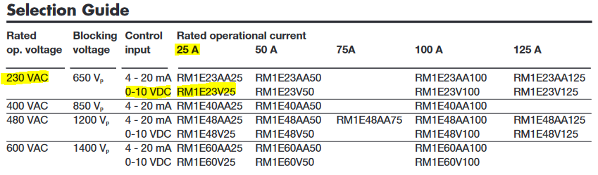

Personally, I went for 230V 25A Carlo Gavazzi RM1E48V50 with 0-10V control. Normally, I would choose a bit more expensive RM1E48V50 that's rated for 480V and 50A, but it was not on stock at that time.
https://www.gavazzionline.com/pdf/RM1EAAdatasheet.pdf
The SSR gets pretty hot during the operation, so don't forget to add a decent heatsink. I went for RHS100 heatsink, which comes together with a DIN rail clip. The only drawback is, that the bundle is too high to fit in a shallow distribution board.

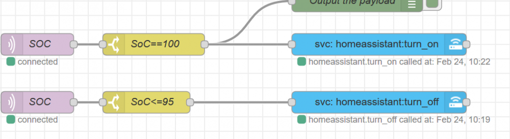

Well, if you can run your whole house on the backup side of GoodWe, then adding such an automation based on the SOC would be pretty easy task. Trouble is, if you need more than 4.6kW, as GoodWe inverters can't be connected in parallel on the backup side.
I generally can. I use "Home Assistant" for my home automation and currently use SonOff devices to make sure I don't run either of 2 geysers or pool pump or bore hole pump at the same time. I also use inverter aircons and fridges so no large power spike from those items. See attached typical load profile for a 24 hour period. One can clearly see the blocks of geyser consumption which I want to smooth out.
I have heard rumors that GoodWe are working on a FW upgrade that will cater for inverter paralleling in the future, but that means nothing until they actually do release a working update...
I have in the passed run the oven off grid during substation/cable fault extend power outages, but to make life easy I would probably automate connecting to grid for an hour during cooking in the evening, to allow for the odd short duration where the microwave runs while a pot on the stove boils and a chicken roasts in the oven.
Another option.
I have a single Axpert 5KVA with 4 Pylontech batteries and 12 x 300w panels. I use the ICC software and also Home assistant. HA/Nodered reads the battery SoC , and if it's 100% it enables a Sonoff relay/contacter to turn the geyser (3KW) on. It then leaves the geyser on until the SoC drops to 95% and then turns the geyser off.
It typically does +-30min cycles till the water is hot.
It makes the electronics a lot simpler than using a SSR.

Hi @1Hallux
I had the similar ON/OFF solution some time ago, when I started flirting with the solar power. It worked exactly as you described, but I was a bit scared by all the cycles that it introduced in my lithium battery. Therefore, I switched to the SSR and continuous regulation, so I can have a good sleep at night :)
