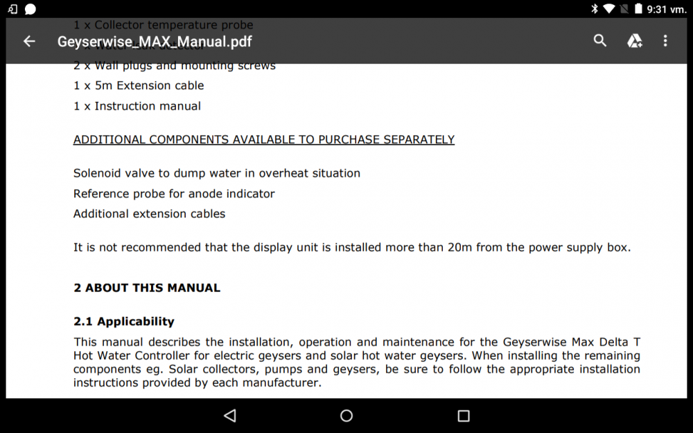

October 26, 20186 yr Author The idea is to try and minimize human intervention, covering up or removing tubes are an ineffective way of reducing the heat and backfires on cloudy days. On 2018/10/16 at 9:52 AM, Chris Louw said: Tersuis . The Geyser Wise Max do have a dumpvalve that is avialable . That looks promising, I have the TSE version installed. Will call them and ask if that model can do the same thing.
