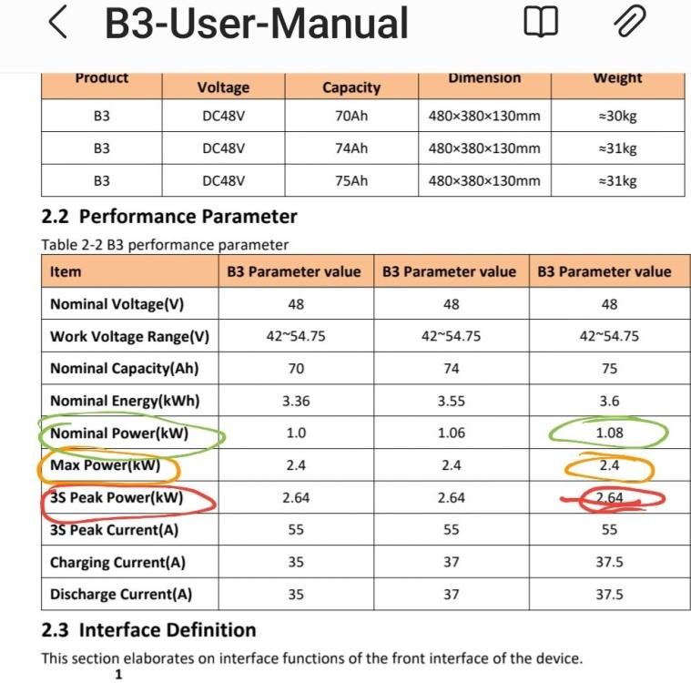

"Max continuous discharge is only 5.4kW"
Interesting. Why do you say 5.4kW? I thought it would be 3 x all the below.
Meaning:
  • Nominal Power 3 x 1.08kW = 2.16kW*
  • Max Power 3 x 2.4kW = 7.2kW*
  • Peak Power 3 x 2.64kW = 7.92kW *
*The info above and the image below is from the manual that came with the battery.
Sorry - missed the 'recommended':
"Recommended Max. Continuous Discharge Current: 37.5A"
I see absolute max continuous is indeed ~2.5kW.
So you have 7.5kW available - but you also need to remember that the inverters have no way to communicate among themselves, so you should set one up for 5kW max discharge, and the other for 2.5kW, or you may get BMS trips which take down everything.
Yes, but fortunately the BMS/batteries were never in danger as they have+-7Kw output. The 5kW Sunsynk Inverter is being "Maxed" out by both Load 1 and Load 2 (not healthy).
On top of that, I desperately needed to add 500W to the existing backup, but that would exceed the Sunsynk inverters threshold 5.5kW in Lab/ideal conditions. So splitting 5.5kW into 3kw on Sunsynk and 2.5Kw on King, will still be below 7kW.) Heck, if it works, I'll add a 4th Battery (On bus bars or 2 x 25mm2)
