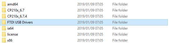

In there is a new "Universal" Driver
And some old Drivers under the "Old_Arduino_Drivers" folder.

I downloaded the program from the Arduino.cc website the same as the screenshot above. My operating system is 32-bit. This morning I uninstalled Arduino and started from scratch but no luck. Thanks for all the advice I appreciate it. I'll keep on trying.
