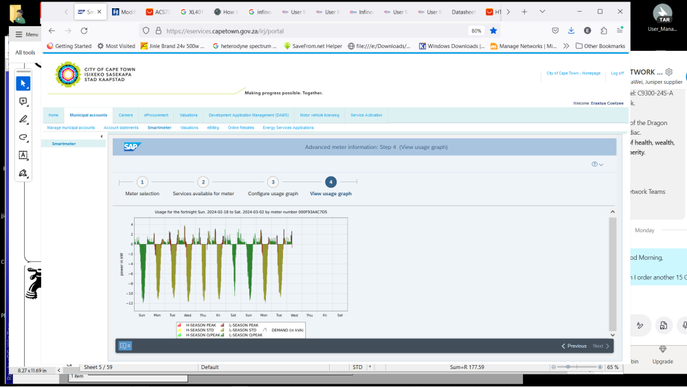

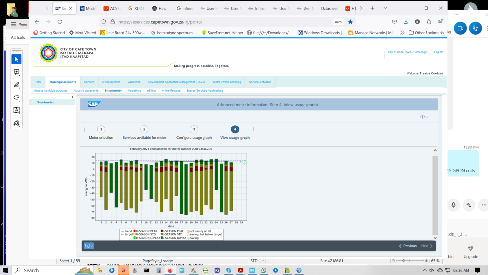

Feb SAP curves on COCT system:

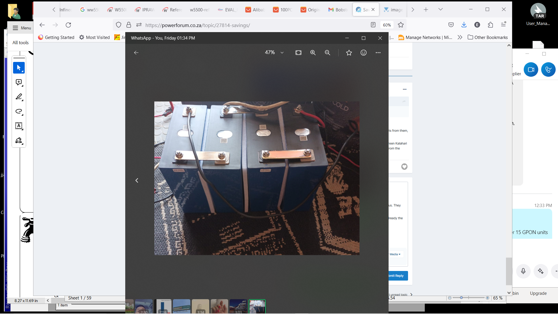

I do not have a smart setup so if you will forgive me.  I do not have expensive stuff.  It is the minimal requirements to comply to the law.  This is a photo of a 12V  3.6KW Lipo battery with 10 000 cycles.
The total cost is about R6900 and it works extremely well.
So if you would spare me the embarrassment.
Hmmm... no BMS, I see and not compressing your cells... no 10 000cycles for that one, I suspect... didn't want photos of your inverters, just all the panels to see how clear they are and how *large* a property you have, since your setup would not likely fit onto most Cape Town city lots, I suspect...

The post was not about my system but about the impact of grid tied and how the COCT put things together so we all can benefit.  But lets talk about BMS.
The BMS I use does the following:
  1. Active balancer.  This means that each 12V sub system has its own controller board with a 5 or 10 amp current supply.  When a cell has a serious issue it will disconnect the batteries and attend to the cell thus the cell will be charged using 5amps and then 16 steps down to .3amps till at the same voltage.  The boards communicate with each other meaning that 4 cells get balanced and 4 cells gets attended too.  When done the batt is switched back. During normal operations the cell that has a lower voltage will get charged and topped up to the same voltage of the other cells without switching of the system.
  2. It monitor the temp between 2 cells and if to high or low it will cut off the battery.
  3. It monitors the charging and discharging current plus rates of each cell
  4. It monitors the ambient C and if outside the manufacturers spec it will protect the battery.
  5. Batt gets disconnect on HighV and Low V
Its all about the life of the battery.  One step more the battery is assembled so that it is under pressure 24/7. This photo was taken during assembly not the final product.
Not sure if you are aware of such system
Thus at 80% of the operational specs this battery should last more than 20 years.
It has a guarantee of 10 years provided data is supplied.
Its not about my system and the looks of it.  Its all about the impact of a proper grid tie system  the savings and the way the City Of Cape Town provides the means to get our municipal account at paid by the sun!!!
Not a look at me I am fancy but a look at the savings through grid tie

Very rough thumbsucks. Just trying to understand the scenario and plausibilise the situation. Not to be naar, just my cautious banggat nature. Open to corrections.
So we take 1 January where you had around 60kWh of self-consumption and 70kWh of export. That's 130kWh of total power, and it seems typical of some of the best days for generation. Less 10kWh of import, which we say was at night, so let's say 120kWh was generated throughout the day.
That's on a system consisitng of (5kW + 5kW + 3kW) 13kW of inverter power at the height of summer, very near within 2 wks of the summer solstice where you could expect 7-7.5 hrs of effective sunlight hours.
Connected panels are in total 44, of which 5x540W, 10x420W, so I gather the rest will should be 29x330W panels. Equals a total of 12.7kW of connected panels. If we're generous, this system could generate just under 100kWh of power per day on 1 Jan. If it should be that you've over-panelled the inverters by 20%, say with 15-16kW or so of panels, you'd be generating more earlier and later, clipping at mid-day, and I'd think your 115kWh of units per day could be nearly plausible, but 130kWh is a stretch.
Be that as it may, what's the point here? Well, it's a lot of panels for a grid-tied system for home. In the past there were discussions of grid-tie being limited to no more than 25% of notified maximum demand, ie. approx 4.6kW on a typical home supply of 60A, with say a 13.8kW peak. I don't know whether it's strictly a law, or whether CoCT is  bothering to apply that limit when it comes to getting more generation on-board. Certainly a typical and common/popular 8kW hybrid inverter is capable of exporting in excess of that 4.6kW limit, but not over 13.8kW, and in it has the benefit of a battery bank behind it that could be charged, and a CT coil that could limit export.
Or do you have a higher 80A breaker, or a 3-phase supply to your home? You haven't mentioned anything so far about the capability of the wiring in your house to carry the solar export, but yet you are planning on adding more to make more money. No mention either of who did the installation and at what cost, and if they gave the CoC. Already today I'd be wondering what happens when your loads take a dip (away on holiday, or circuits trip), and there are some cloud-edge spikes mid-day. Will you be tripping the mains more frequently? Is there an increased fire risk? When is it enough? When is it too much?

Nope,
Lets take 1 Jan
The home use is not currently working as I have removed my 3 phase multi direction meter. Its a 3 phase 3 direction meter that is multi function device and ....
Thus it measures home usage, import per phase power in per phase from inverters and exports per phase.  Not the average device.
So I do not have exact figures on that.  My rough usage per day with solar is +/- 16KWH without solar I use more than 45KWHR
So ignore that column please. I am just lazy to reconnect the "meter" and get the data into the records.
(5k2W + 5k2W + 3k5W+2k5W) = >15Kw.
The panels are so stacked that 3 inverters runs at 100% and max out early.  Thus I have more than 5Kw for the 5 KW more than 3KW ...  solar panels and I have some lying on my roof not even connected. They are for the "new" 7KW inverter.  I dump solar when the sun is at max so that I loose less in the winter. Too many KW from the panels for the existing system.
X panels are 330 & 405, some 420 and others 550W. I think in fact I don't know exactly the ratings of the panels. I can assure you they work.
The inverters has dual separate in puts.  That's a huge plus
So as I stated its not about my system its about the way the COCT structure the grid tie so we can benefit from it.
No matter how anybody argues its about the account from the COCT and the savings and that is accurate.  My savings are more than R6K per month.  In fact my total saving on solar will create a stir if I pen it.
