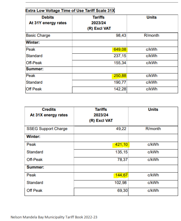

27 minutes ago, Scorp007 said:
Now a twist in the tail from systems that are common. What about storing power in batteries and then discharging it at night via the grid tied inverter. It does not increase the daily export ability but excess PV during the day can be stored and exported at night.
This is trivial to implement with Sunsynk/Deye inverters, but the economics must make sense.
My favourite high-level calcs, take a typical Lithium solar battery, just say R24K cost, into which you can cycle 5kWh of power down to 20% up to 6000 times. so that's 4kWh*6000=24000kWh over expected life of the battery. Effectively costing you R1 per kWh that you cycle. That's without the cost of the panels and inverter, or accounting for losses, that's just assuming you happen to have some surplus generating capacity that's otherwise sitting idle and you're thinking of using it to make money out of the system selling at peak times.
At a CoCT flat payout of R0.87+R0.25 you're lucky to make 10% profit back at least for now on selling battery power.
In the rest of the country you'd be losing money because you can't make back the cost of the battery.
With solar daytime export alone, you'd probably still be making money during the day, more so if you got your equipment at bargain basement throwaway prices.
Exception if you're in our beloved Nelson Mandela Bay, which uses the Time-of-Use tariff scale for debit and export credits as below. In this setup you'd still have to be a net consumer, but being able to export during the peak periods could be viable to bring the total bill down. As long as you can definitely, absolutely, avoid buying in electricity at R6.49/kWh in the heart of Winter peaktime. A pure grid-tie will not allow this, you'd have to go hybrid for it to make sense these days.
And the final part of this opinion, that exporting to the grid is great in theory, but there are pitfalls too especially depending on where you live.
