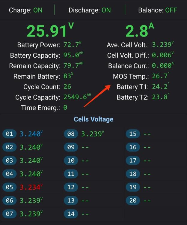

More or less. The problem with most BMSes are that once the 1st cell reaches the upper voltage charging would stop. It does not mean all cells are fully charged. Thus one uses a trigger from the highest/lowest cell but that is a false indication for the battery as a whole.
Also we might balance at 2A while charging at 40A. This high current causes a cells or 2 to run away and charging stops. The same during discharge. One just needs to check the values on the APP to do fine tuning.
AFAIK even keeping lithium at 3.5-3.55V will get them to 100%. You just have to see what the 95% level might be but bear in mind the charge and discharge currents affect the voltage seen by the BMS.
I placed the picture of the per cell volts to take care of 15 or 16 cell batteries.
