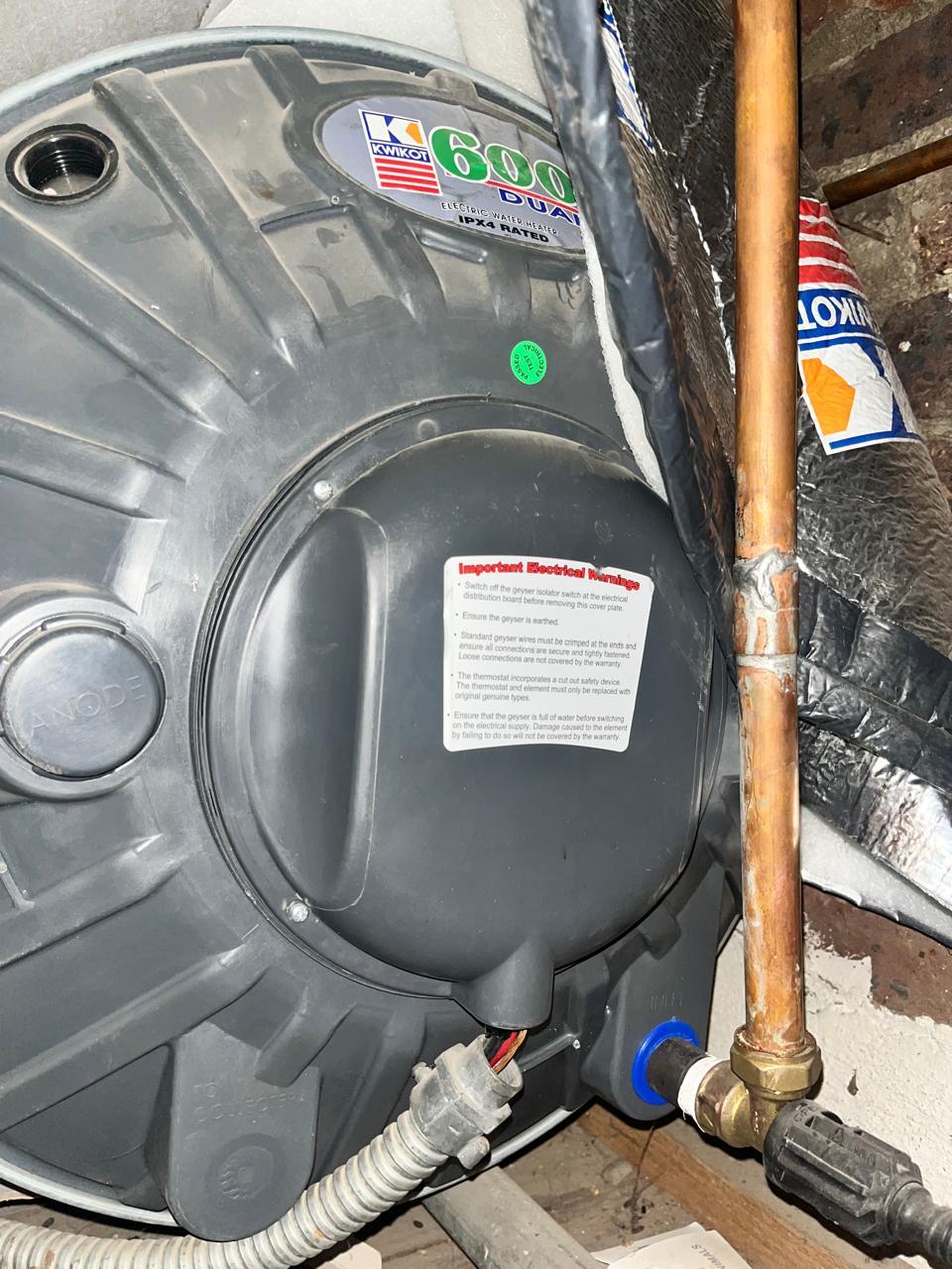

Looks to me like a 3kw (Geyser 1) and 4kw (Geyser 2).
Attached are images of Geyser 1 (mounted outside) and Geyser 2 (which has the Kwikot 600 Dual sticker on it).

You could get a Geystertech unit? No modifications required to the geyser at all. It costs 3k for the unit. The unit can use grid or the panels. That is what I currently bought for my geyser as I did not want the geyser running off my inverter and batteries.. The 3k unit is for up to 150 litre geysers. They have a unit for 5k that is for 200 to 300 litre geysers. It outputs a modified sine wave so does not kill your thermostat.
I skipped Geyserwise as too many reported failures, too expensive and I dont want to use some fancy AC and DC element. I wanted to be able to keep my standard element and when it pops just replace with the standard elements that cost 300 rand, not some element that costs 1.5 to 2k.
