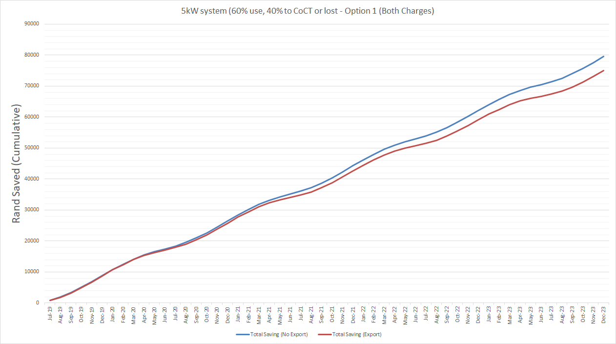

I have had quite a few people asking: "Should I do net metering (or exporting) to City of Cape Town?"
To answer this question I have done a quick analysis on the pricing, costs and exports.
Note a few assumptions on the below:
1. The Cost of installing the Net Metering Meter is NOT INCLUDED (this is around R8k to R12k)
2. Escalation of electricity price is capped at a 5% rate (after 2020, the 2019/2020 increase used)
3. No Escalation on the Feed-In Tariff (The possible increase in FIT is offset by the reduced Electricity Cap rate, also note the new changes to the SSEG rates by City of Cape Town [very much reduced])
4. Home usage is more that 1000units(kWh) per month, however should this be less than 1000kWh then the excess energy is sold to Cape Town (or lost if not exporting)
5. Access Fee per year (currently 248p/m on the 2019/2020 budget), changes by 5% annually
Then, two options are given side by side, this is depending on how CoCT will be implementing the fee structure (sorry, there is no clarity on this, perhaps someone can assist?)
We have two charges on for Home Users, which is a R160(+-) "Network Access and Administration Charge" and the other is the SSEG "Service Charge" R248.32. Option 2 will be WITHOUT the Home User Charge, option 1 is with both (most likely scenario).
It can be seen from the graphs over a period of a few years that Exporting to the City will REDUCE your saving vs. just tossing the energy in the bin (figuratively speaking, if you do it literally you might have to pay for the fire department to come out...).

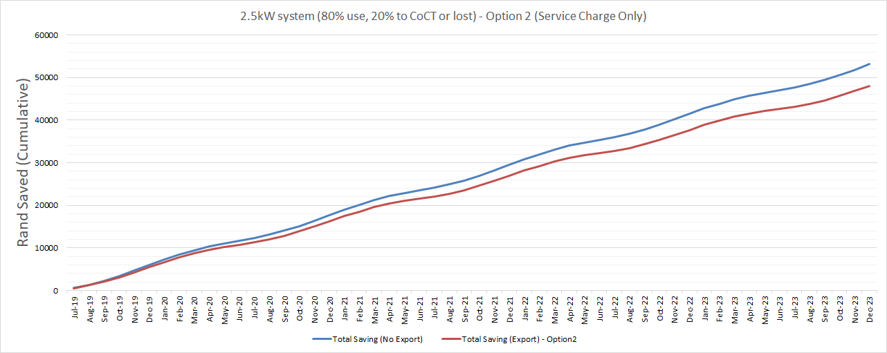

OPTION 2: Only the Service Charge (I like being optimistic):
Very interesting, I believe you save in one form or the other though, by reducing the load on eskom and in doing so helping the economy. It would be nice if they a least make it break even if you sell back as apposed to dumping it.

@flamegrilled, I thought of it but how would it be best put in? Trying to keep it simple, would you go for a negative saving at the start or would you want to take the approach of wirting off the cost over 5 years (first option would be accurate, if you want to do it over 5 years then interest should start coming in).
My intention here is to show that should you have two exact same systems (and had the meter installed already), then the discrepancy becomes more prominent over time. Note this is only 4 years, so the longer (say 15 years) you go along the worse it becomes!
I am more than happy to upload the base document if someone wants to play around with it and make more useful figures.
The data used is as follows:
1. My own home utility bill per month
2. PVSyst estimations of monthly energy generation for a 2.5kW system (sized specifically so that I have 100% utilisation), also the system has less than optimal placement
3. Energy loss of 0.05% per year (this is not 100% correct as I actually used nicely oversized DC component - and due to West facing placement for 1 string)
