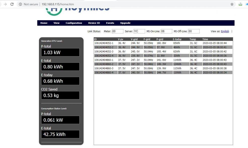

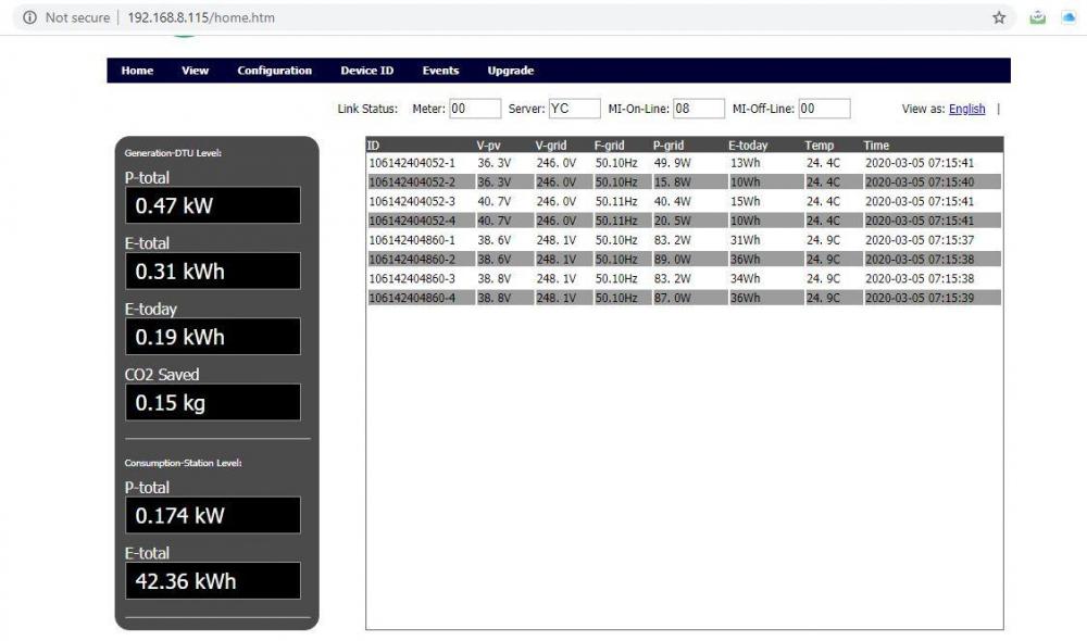

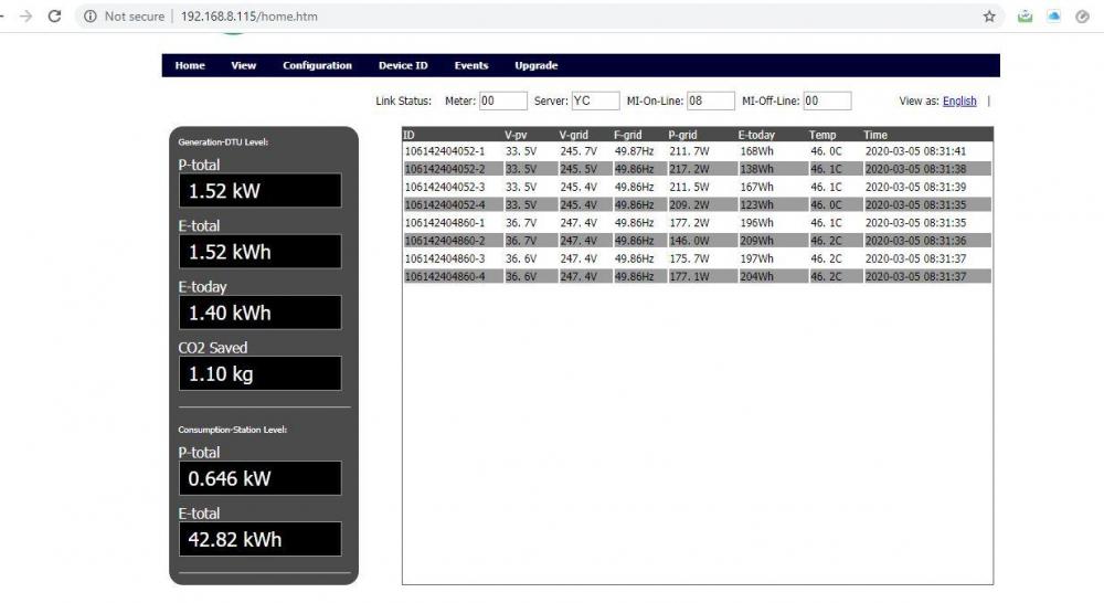

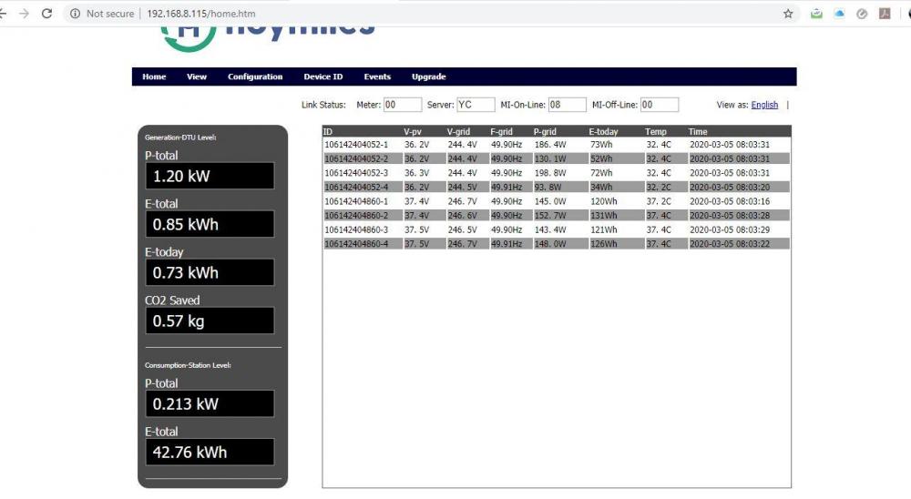

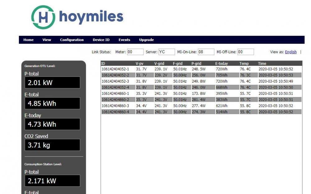

March 6, 20206 yr Morning Zialmen How do you know when the Hoymiles microinverters are throttling production to match consumption? If you look at the images below, there is only 1 time where the Generation DTU level is lower than Consumption P-total? I would like to turn on more geysers and use the power if it is there. So should my consumption exceed / match the generation to prevent the Hoymiles microinverters throttling production? is there any way to see a graph of the P-total VS the consumption? I only have 8 panels, so am a little surprise that generation is exceeding consumption? Thanks for your help Barry
