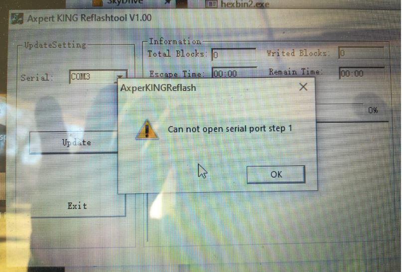

Ok I have now tried 2 laptops, Windows 7 and Windows 10, also 2 different USB>Serial cables with no success. My last resort this weekend is getting an actual old desktop from a museum and trying again
I updated my firmware yesterday using a serial -> USB adapter running Windows 10.
Is your serial port set as COM1?
Do you have a bunch of anti-virus software, etc. on your computer or something that could be blocking this maybe?

My worry is that the one inverter when switched on only has a blank (off) screen. I can hear it switching on and relays clicking. I also know that it took the 2.49 update. How long should I wait after starting inverter before I click in the Update firmware button.
If it turns off and never shows progress on the update window, it failed before even starting.  I had that before on a Windows 7 machine that was quite bloated, something on that install probably interfered .  I fixed it by downloading a Windows 10 live boot cd, boot from it then used that.
On that machine it would say it is starting, power down the inverter then fail.  The only way to recover was to turn off power to the inverter (AC & DC) then turn it back on.

Sorry to hear that you are still struggling - are the symptoms still the same (as in it hangs up partly done), or does it not start at all now?
It is still this issue....
On 2020/07/27 at 7:38 AM, Plaashaas said:
I changed the COM3 to COM1 and restarted my computer with no success. Using Windows 10

Yes set to COM1.... Also tried 2, 3, 4... no luck. (Also tried restarting laptop after changing COM designation)
Then my advice is to use a bootable windows 10 live cd.  Also I don't agree that you should be using an old computer with a serial port on it.  I would use a USB -> Serial converter.  Not all computers supported serial ports that had true RS-232 voltage levels.  However most USB -> Serial converter do support it.

3 hours ago, Plaashaas said:
Press ON button on Inverter.
Wait 10 seconds (Counting Mississippily)
Press Update.
This could be the problem. Can King users please estimate the time from switch on to when the countdown starts?
Based on my other one.... it takes about a second and then starts counting down from 6

3 minutes ago, Calvin said:
One thing that ha embarrassed me in the past (with the "cannot open port") - If Watchpower is installed make sure that it is completely closed - incl the system tray icon.
That I have done for sure.
My experience has been that bad USB serial adapters will start the process but not complete it.  Failure to open the port (in my case anyway) has always meant it is in use by something else.  Can you open the port in a terminal program?

2 minutes ago, Plaashaas said:
I have long since given up looking stupid.... I am desperate now so..... Terminal program???? Meaning "Device Manager" >>>> com ports ???
As I said, I don't trust your Windows install.  I would use a Windows 10 Live CD to rule it out.  All these things to try see what is blocking it.  Instead rule it out.  The live CD boots into a Windows 10 environment that is the same every time you boot it, you plug in the PL2303 (and install the driver if needed) and set it to COM1.  I did 1 year ago when I had the same problem that it couldn't open the port.  I posted that on the Australian forum, others tried it also and it worked for them also.
