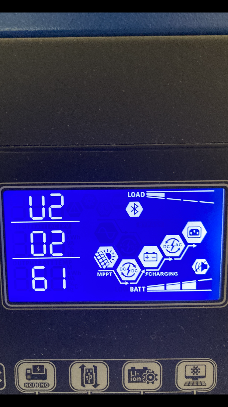

Hello all
I have upgraded my axpert king with 71.95 so no issue things worked well
now which firmware should go for for display Bluetooth or mcu
please help
20 minutes ago, Calvin said:
My Kings run happily on 02.60 with 71.95, but I would imagine the latest available (02.61?) would be the sensible version.
Can you share download  link for 2.60 so that I can safely download and upgrade firmware
