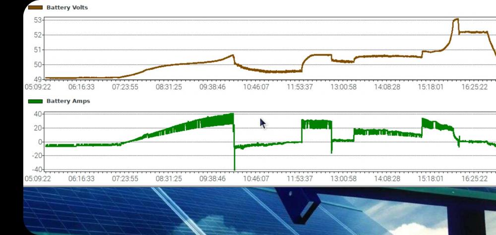

So yesterday I added another us3000b (4 now in total) and updated the remote display and DSP firmware to 2.49 and 71.92.Today i've noticed my king seems to have an issue keeping track of how many batteries I have. It shows on the remote display any number from 1 to 4 randomly! My battery charge limit changes between 30A and 140A randomly too, causing my solar not to run at its full potential. Not sure if this is a Battery BMS issue or a Inverter issue. Anybody else experiencing this ?
@RichieRich,
What was your previous main firmware version?  Did everything work correctly with it?
I have 71.93 if you want to give it a try.  PM me if you want me to send you the files.
I'm having the same issue.  The battery charging amps would continously drop to 30 and then back to 100 amps.  The screen from today looks much better than previous days, will post another tomorrow when the system is under a bit more load153686027_Screenshot_20200809-171142_VNCViewer.thumb.jpg.d878c6b12af07bb7be2d126ba5faac46.jpg
