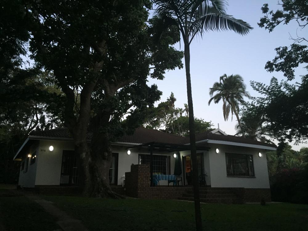

August 2, 20197 yr I am planing a solar installation at the South Coast and have a problem with lots of shade due to high trees. Is it worth considering a wind turbine, or is it uneconomical as I have recently read. The property is high and normally have a nice draft. Than there is a problem with monkeys and I don't know what they will do with a wind turbine. Any input will be appreciated.

August 5, 20197 yr Author 10 hours ago, DeepBass9 said: cutting g the trees down? Some of the trees are also from my neighbors property, I do sometimes trim the trees around the house but would not want to cut them down, my wife would also not forgive me. Normal PV panels might be ok but I think I will loose some efficiency.
August 5, 20197 yr It would be a tragedy to cut down those trees, I thought maybe they could be blue gums or something. Just my experience with a wind turbine, firstly you need a lot more wind than you think, and when the wind does blow, it is often not when you need it. Also wind turbines are expensive, calculate the number of solar panels you could buy for the same price. Edited August 5, 20197 yr by DeepBass9
August 5, 20197 yr Author 28 minutes ago, DeepBass9 said: lot more wind than you think Yes, the trees do block out lot of wind that will also have a negative effect on wind turbines. I Should maybe install more solar panels to try and capture as much as possible of the midday sun.
August 5, 20197 yr I think it would be best to try and figure out the best place to put panels, and then oversize a bit for the shading effect of the trees. Is there the possibility of putting up a carport type structure somewhere with better sun? The other thing about wind turbines is they are noisy and your neighbours might not appreciate that. Edited August 5, 20197 yr by DeepBass9
August 5, 20197 yr Just as a warning. Wind turbines are noisy. Very noisy. I don't think you would be able to live in the house with one above the roof.
August 5, 20197 yr Author 3 minutes ago, DeepBass9 said: Mine is about 40-50m away, and I can hear it now as it is windy today. OK thanks that puts the wind turbine question out of the way, would rather not go that route.
