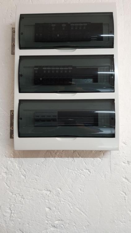

September 13, 20197 yr Used 25 amp blocks, bright spark who wired the house never left enough slack in the cables. I can either run new cables or replace the blocks with ferrules. Looking at making a flat wooden frame for the db to mount on, then i can hide the hinges on the side. Planning on using the lower rail for the hager sf263 change over switch and red and green indicator lamps.

October 23, 20196 yr Author Me again.... @Shockin what did you use on the other side from the hinges to keep the board from swinging about? Or did you just use stiff hinges?
October 23, 20196 yr 12 hours ago, Bobster said: to keep the board from swinging about? He used screws 🙂
