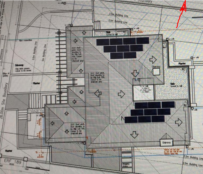

Heinds Posted October 13, 2019 Share Posted October 13, 2019 Hi Guys In the final stages of completing a newly built home. Planning on installing the following: 18 x 350W canadian Solar Panels 8MW Solarsync hybrid inverter 9.6kWh Dyness power box L-Ion Battery Here is the roof: House has 4 bedrooms with bathrooms (3 upstairs and one guest below) Only 2 people staying in the house for the greater part of the year (Guests will use room below and maybe upstairs but no longer term stays until children arrive in few years) Shower in evenings and mornings My idea was to install 2 x 150L kwikots and use the 1 for main bed and kitchen downstairs and only turn on/use the other one when guests arrive So my question is: What would be the best here when it comes to saving water and electricity and available roof space? (Note North and also note that i have no problem moving panels.) EV Solar, PV Solar or Heatpump? The inverter also has the function/ability to feed excess power to the geysers. This is in Cape Town. Any advice/opinions would be appreciated. Quote Link to comment Share on other sites More sharing options...
PeterP Posted October 13, 2019 Share Posted October 13, 2019 As with most of these questions - it depends. If you have enough excess PV power during the day to run 2x 1.5-2kW element for 2hours then thats your solution. If your load-profile won't allow the geyser load without having to add panels then it will be slightly cheaper to much of a muchness to add EV-tubes as opposed to adding extra PV panels. Heat pumps are typically only viable on bigger systems for water heating + they require maintenance and have shorter lifespans. Quote Link to comment Share on other sites More sharing options...
Heinds Posted October 13, 2019 Author Share Posted October 13, 2019 6 hours ago, PeterP said: As with most of these questions - it depends. If you have enough excess PV power during the day to run 2x 1.5-2kW element for 2hours then thats your solution. If your load-profile won't allow the geyser load without having to add panels then it will be slightly cheaper to much of a muchness to add EV-tubes as opposed to adding extra PV panels. Heat pumps are typically only viable on bigger systems for water heating + they require maintenance and have shorter lifespans. Thanks for your reply Peter Quote Link to comment Share on other sites More sharing options...
