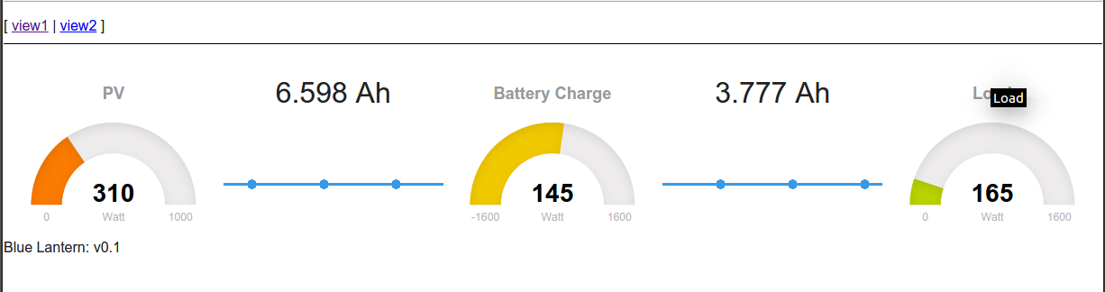

Put in some time on the weekend. Dropped the "percentage load" gauge. Originally copied that from a screenshot jdp posted (and I was a little nervous about it :-P) but I finally figured it adds no information, because the Load gauge already gives you a visual indication of what's going on anyway. Rearranged the gauges so charge flows from left to right. Added CSS/javascript animation, speed of animation actually adapts to how much charge is going in/out.
Finally, I added Amp-hour counters. So far it's not stored, it simply starts at zero when you restart the service, but I'll do something about that later. For now, it's just a test to see how well it works, compare with the real number shown by the charge controller, and things like that.
Picture attached. Live example at http://ispburger.ddns.net:6543/

Hehehe. When I still did websites I remember what a pain that was. Either buy stock images, or use your own. At least when it comes to ideas, often they cannot be copyrighted, they are just too simple or obvious. It was a good starting point though, I think I now have something to work with. The problem I have is that when it comes to UI design, I'm not terribly talented, so I have to gather ideas about what works.
This is now a combination of the gauge idea that you started with (and I see TTT copied as well :-P ), with the dotted line indicator "stolen" from Victron's CCGX. Truth be told, I don't think the gauges works for everything. See this as constructive criticism TTT, I'm sure you are aware of some of it :-)
I think using the same gauges for everything is a mistake.
1. "Total to date" should just be a value I can read.
2. Battery state of charge should be a picture of a battery with a part of it green (like a little water tank with green paint in it).
3. Voltage gauge should not start at zero, a 24V array would be empty at around 21V, and that part of the gauge should not be green :-)
I'm already picking up some issues with my "design" too. The Battery charge indicator, for example, goes from red via yellow to green. So its green when lots of charging is happening, red when lots of discharge is happening, and yellow the rest of the time. Which means it spends a lot of time in the yellow zone (while float charging for example) while there isn't really any "warning" condition about. So I'll have to think about this.
Perhaps I do have a tiny bit of talent... :-)

Was lazy last night, went to bed early (aka 11pm). Saw something interesting just now that might be of interest. Look at my Watt-hour and amp-hour counters. They were reset late yesterday afternoon as the batteries started discharging, so the counter on the right ran up to about 1600Wh over night while the one on the left was left more or less at zero. That means that as soon as the one on the left surpasses the one on the right, I have more or less repaired the damage of last night, right? Now notice how in terms of Wh I've put back the discharge of last night, but in Amp-hours I haven't. Voltage inefficiency at play... you recharge at a higher voltage :-)
