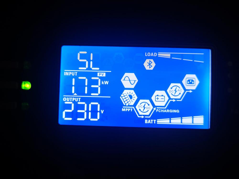

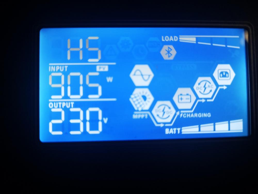

I have 2 Axpert Kings installed in parallel, however for some reason the one Axpert is always producing roughly half of the what the other inverter is doing. This is regardless of what is happening in the system, full batteries, charging batteries, mixing between grid and solar, full load.
Both panel setups are on the same roof, facing north orientation, same pitch currently set up as 3 strings of 4 Panels (Will be changing this back to 4 strings of 3 panels) going into each Axpert. No shade covering the panels during the day.
Any ideas of where I can start tinkering to find out the problem?

I see from the above that the battery is fully charged, when this is happening what is the load on the system as from the display it would seem low.
I had the same issue with my King when first installed, the unit will only draw the PV power required... i.e. If the battery is full and the load only requires 2.63kw, that is all it will draw, irrespective of there is more available.
From the load indicator, this would make 100% sense as presumably you have 2x Axpert King 5K units, which look like they are under 25% load.. i.e. a combined 2.5kw, hence not pulling more than 2.63kw when taking into account system losses.
Why it is not pulling even from both, who knows but you will most likely find that the load is not being evenly pulled either and this may explain the disproportionate PV.
Easy way to test.. increase the load and see what happens to the PV generation :)

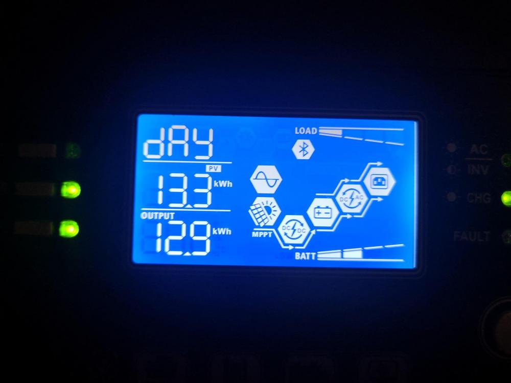

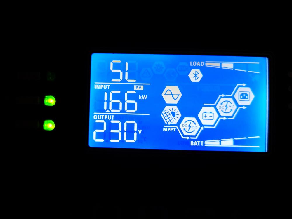

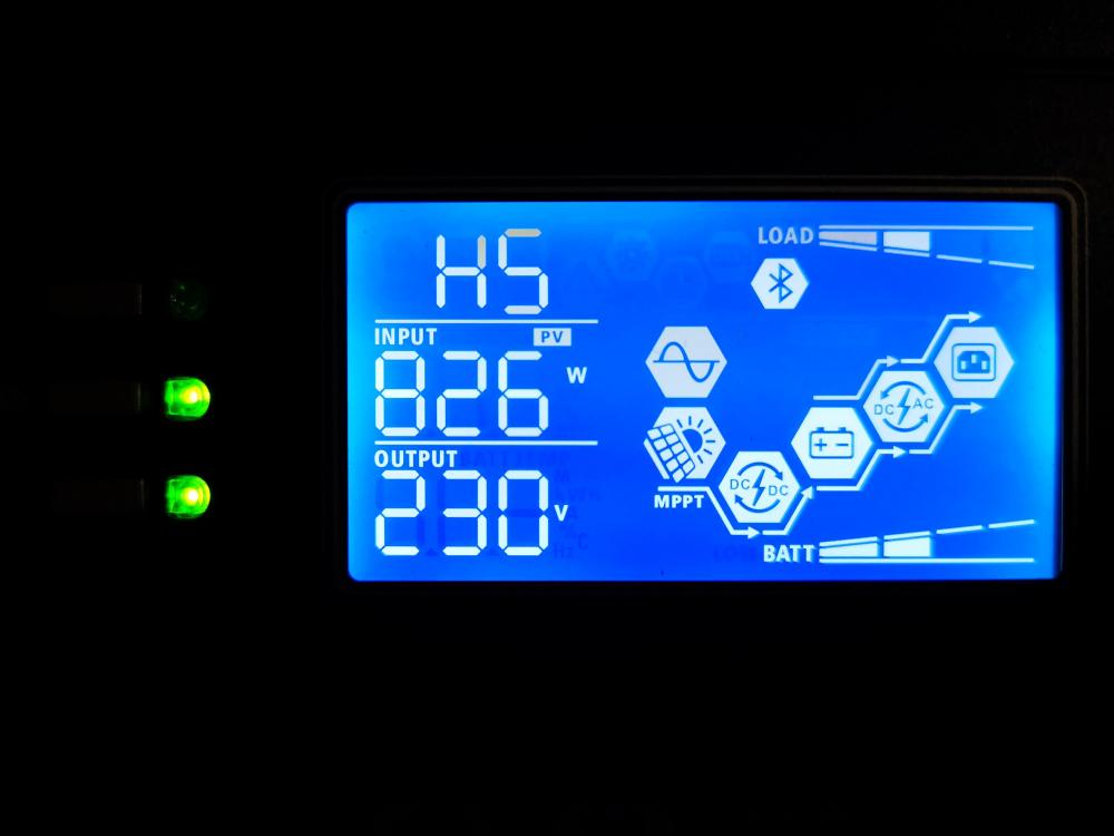

Hi Jay-dee, thanks for the insight, however I pretty much ruled that out too.
See below pics when I had half batteries and half load, and it was still only giving me 50% of what it should be giving.

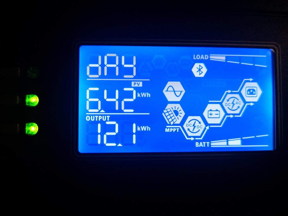

However one thing I have noticed if i check the production for the day, the load also tends to differ between the two. Not so much in the pic, but it has been up to a 2kwh difference before.
