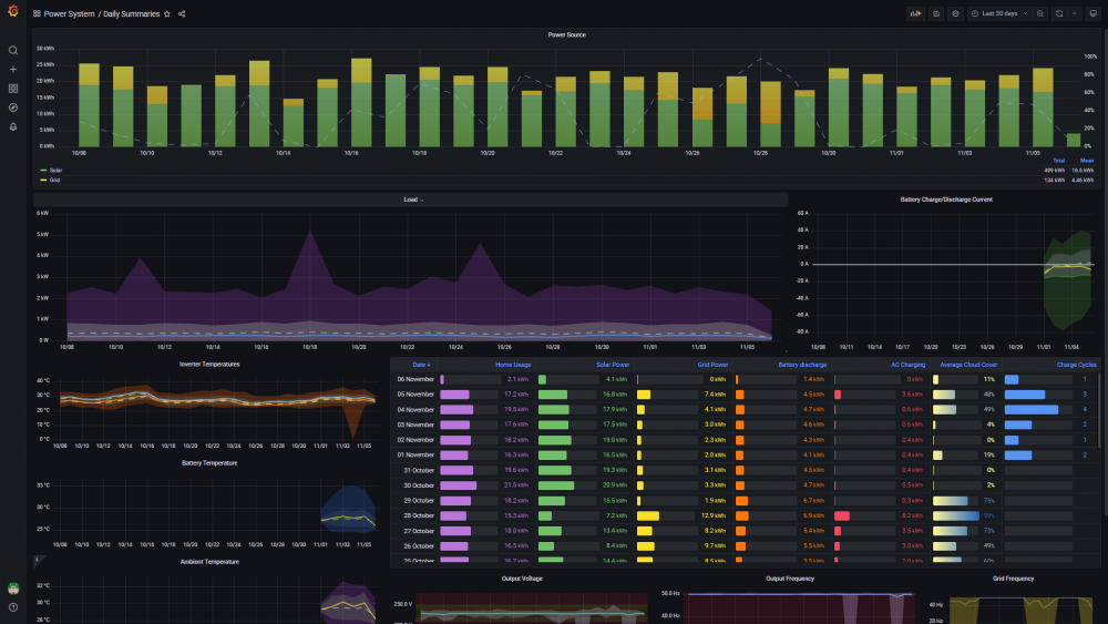

@roadkill The information it's retrieved from the battery BMS and the two growatt via RS 485 connected to Raspberry PI,  it's a program developed by my son, I have to be honest with you, I'm BC ( before computers) we are not using the growatt server, the information is archived in our server at home.
See last 30 days of info.
Do you have some info on this dashboard?   I use Grafana for my Solis bit this is really nice. Can you share?
@MikeN Yes, I use Grafana, here are a couple of my dashboards.
I will ask my son if he is prepared to share it. He programed it and he connect the inverters and battery  with a raspberry PI, honestly I don't now anything about how he got the info from the inverters and battery.
