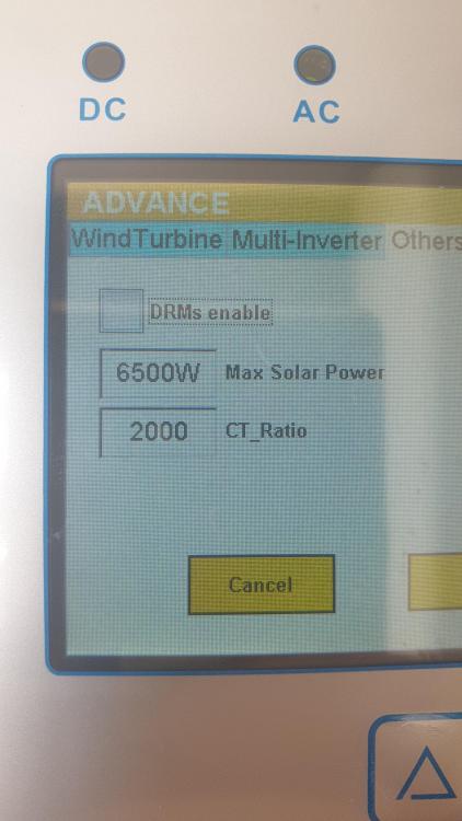

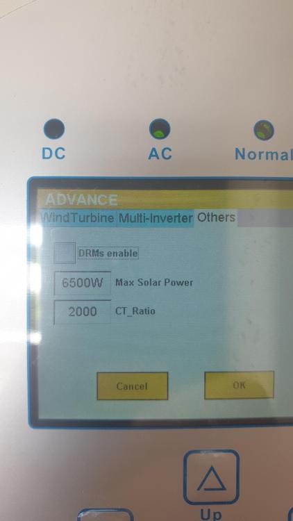

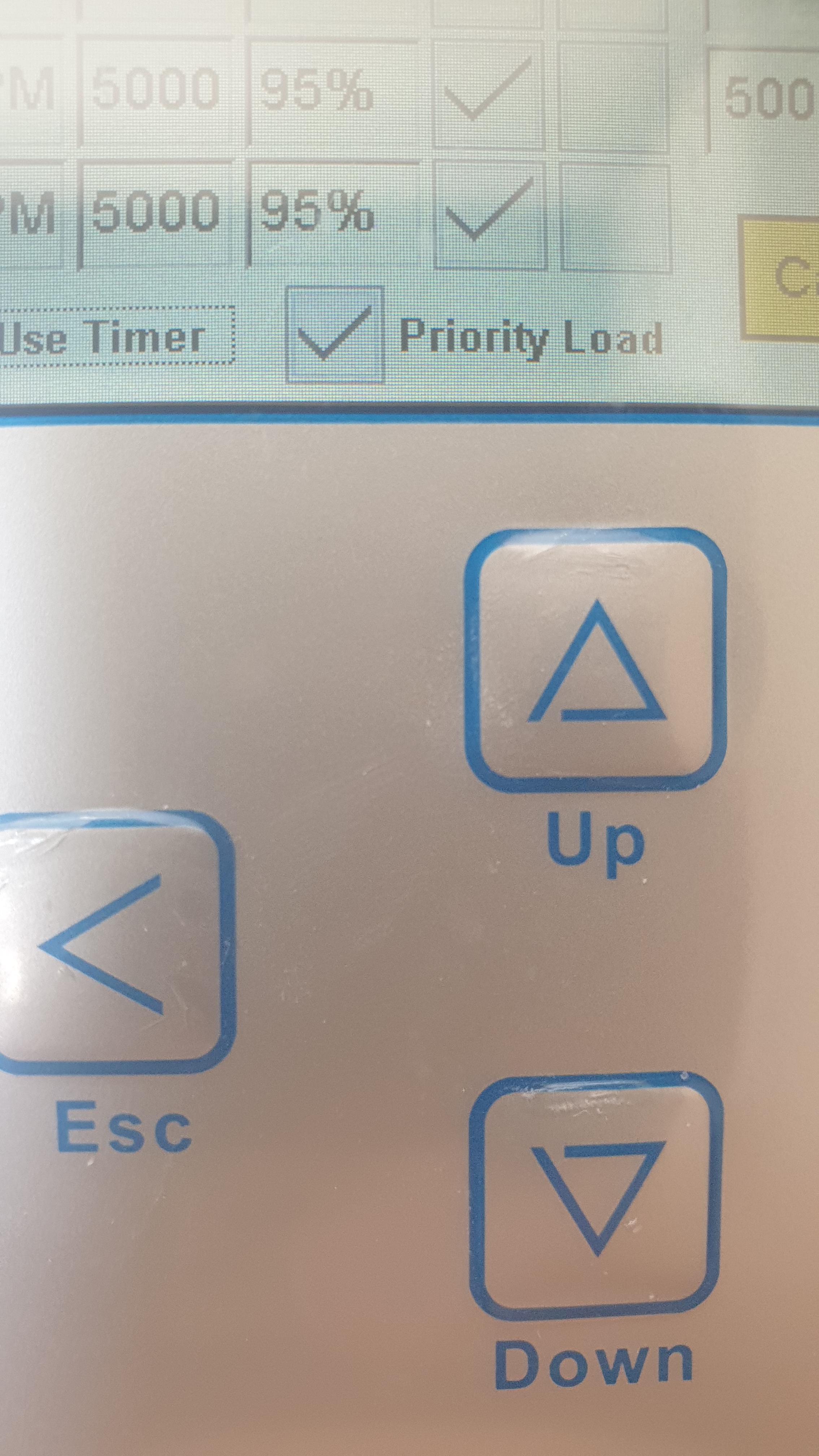

4 hours ago, Energy-Jason said:
Great okay so this is what Sunsynk SA helped me. DRMs off.
CT ratio 2000
And priority load ON
Let me know how it goes.
Unfortunately the Deye's interface is quite different and I was not able to get the CT Ratio. Able to locate DRM. Which one is the CT Ratio and Priority load?
