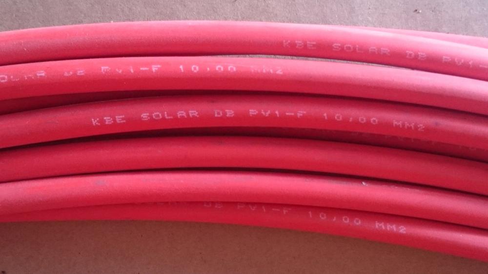

Might be cheap chinese knockoff solar cable as well.
Then again, it might not be cheap Chinese knockoff solar cable. :P
Or maybe a typo.
I get my cable sizes wrong most of the time. Even installers have to 'guess' most of the times I have noticed.

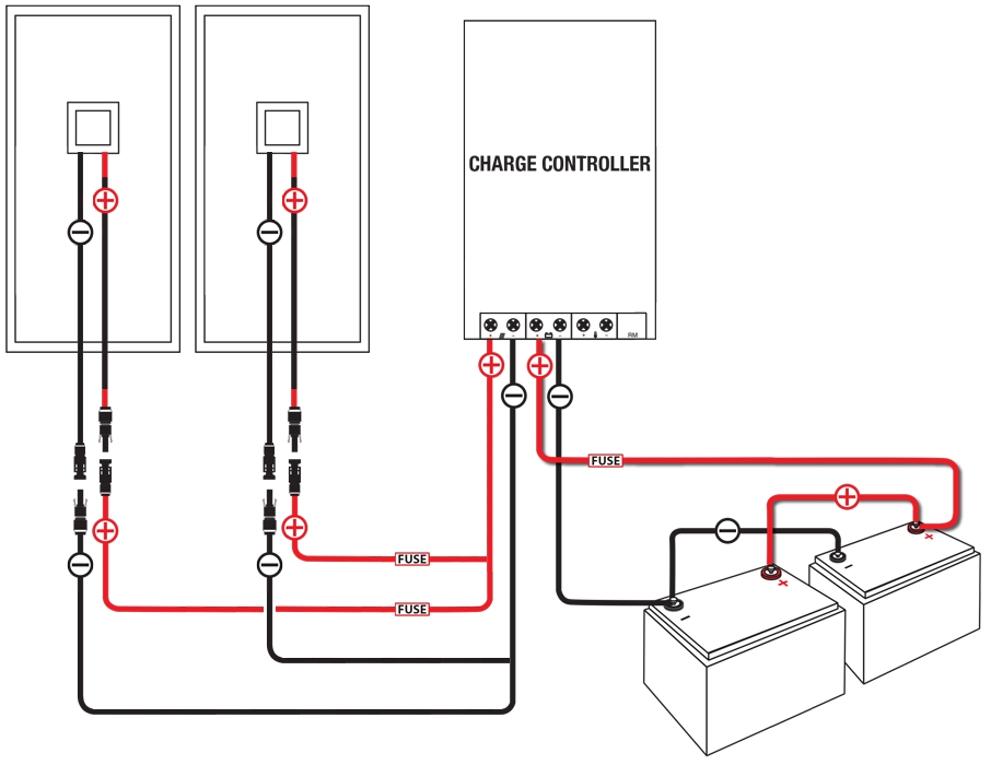

    The image for the wiring has just appeared. I do not like the way that it is wired up. The electrical path for the top set of batteries is shorter than the bottom.

The "right stuff" is clearly marked ;) Solar cable needs to confirm to certain standards. Other cables don't and may be rejected by your insurance if a fire might come from it.
Jip, them are the ones I bought.
My problem is that over time with handling those markings rub off on THAT piece of cable you want to check. Very frustrating.
I like the ones where the markings are part of the insulation ... till the wire length used is that one piece that was cut between the markings. (facepalm)
