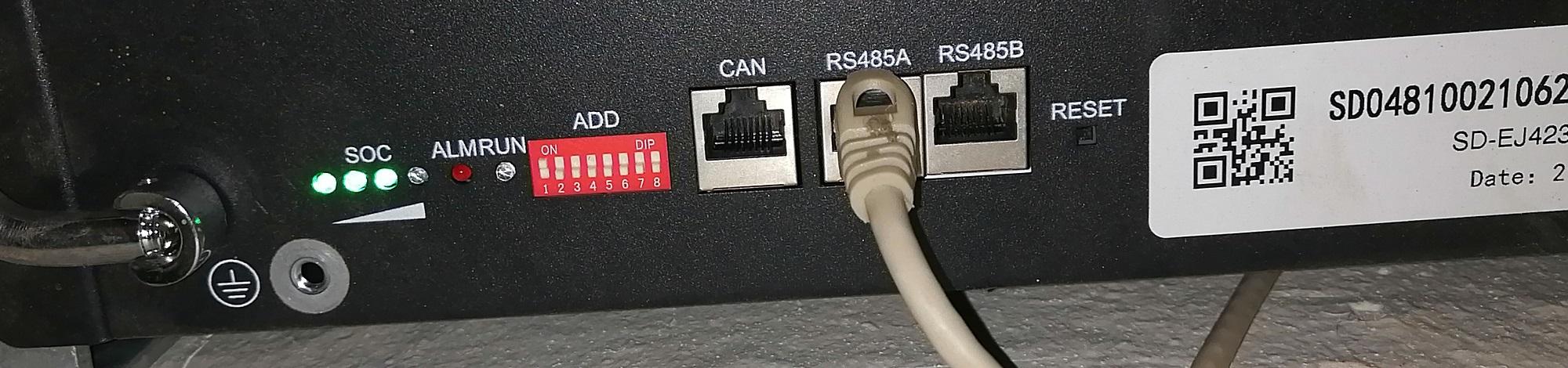

This graphic suggests RS485A <-> RS485A. Not quite sure what the original source is, but it seems to be legit. Curious why one battery is earthed and the other one not.
I also noticed the missing grounding wire on one of the batteries.
It's ironic that the ungrounded battery is the working one.
I will switch the rs485 wires around, but the fact that there is no light on the battery leads me to believe that this might now bring it back to life.
How would you know if the batteries are talking to each other?
