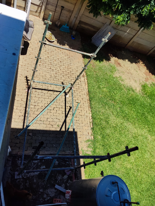

Hired scaffolding for the roof access. Ladders just aint gonna cut it. Waiting on my contractor buddy to come help finish it and ensure its anchored safely and all that jazz.

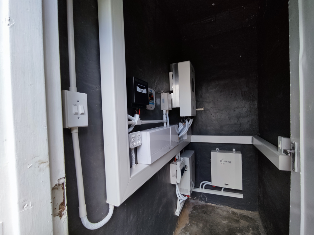

Battery trunking done but I'm not 100% happy with the 40x40mm. Its a bit tight so might switch that up to 50x50mm and also lower it by a few cm. The room is already elevated but if there's ever a flood I'd like it to not get wet.
Added a dual plug to the room. My backyard lawn is just out the door so it can serve multiple purposes. Better to have it than not.
Installed this isolator which has a 21mm hole drilled right through the wall behind it which goes to my carport. Installed a weather proof plug for pressure washer.
Isolator is to switch off and not give someone access to power when they have ill intent.

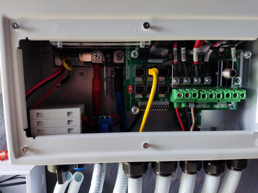

Got 35mm2 cables made and crimped with the sprag. Disconnector to inverter cables came out about 5cm too long but still fine.

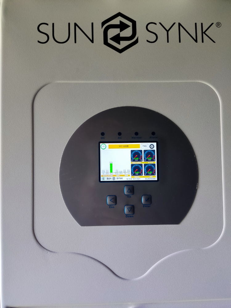

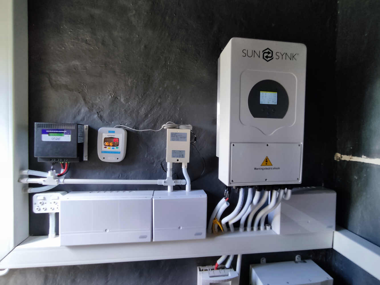

Powered on the inverter today from battery source alone.
Power Room's plugs and lights will run from Aux on the Sunsynk.

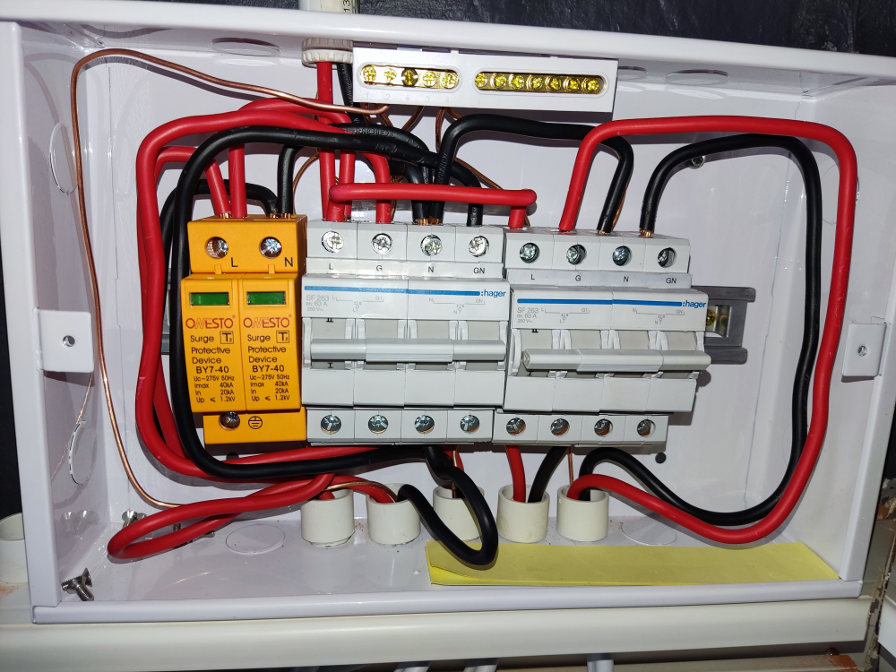

The power room DB wired for plugs and lights. Got the wrong busbar so made little bridges till I get the right one. Input is 2x2.5mm since I don't have 6mm. Max load one this board will be around 20amp so all in spec. Just need to get a 50amp breaker and then also add a Earth Leakage breaker.

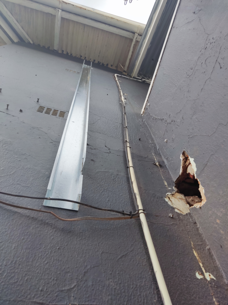

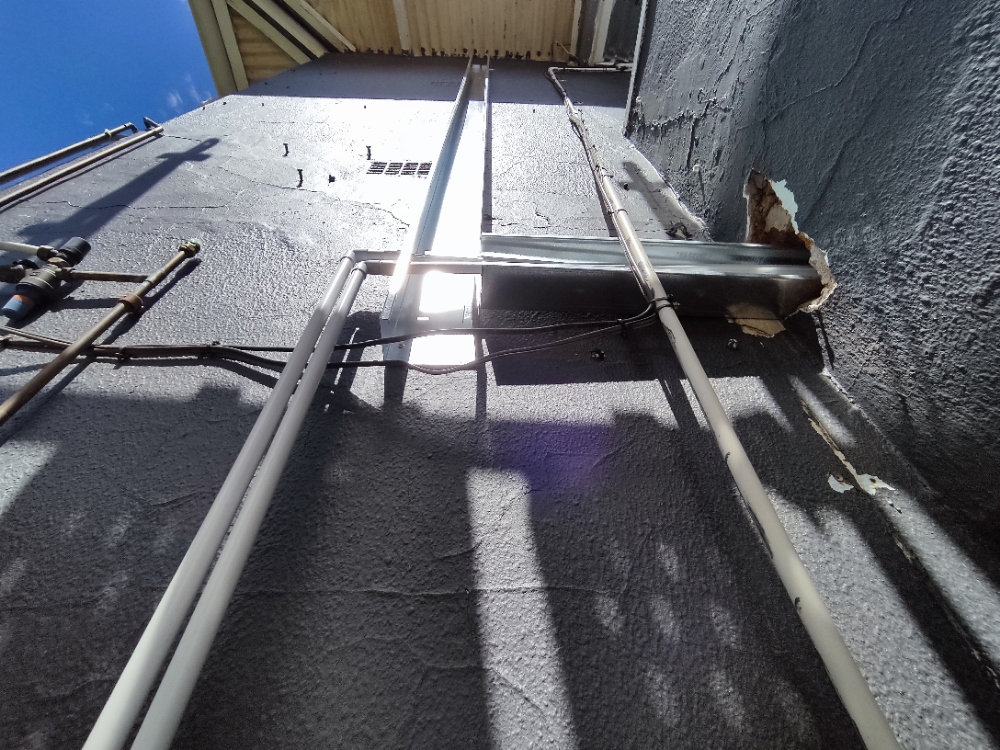

Main trunking added from power room up to the house. Core drilled two 50mm holes. One will be AC and the other DC.
90 from the power room to meet main trunking.
Inside to outside.

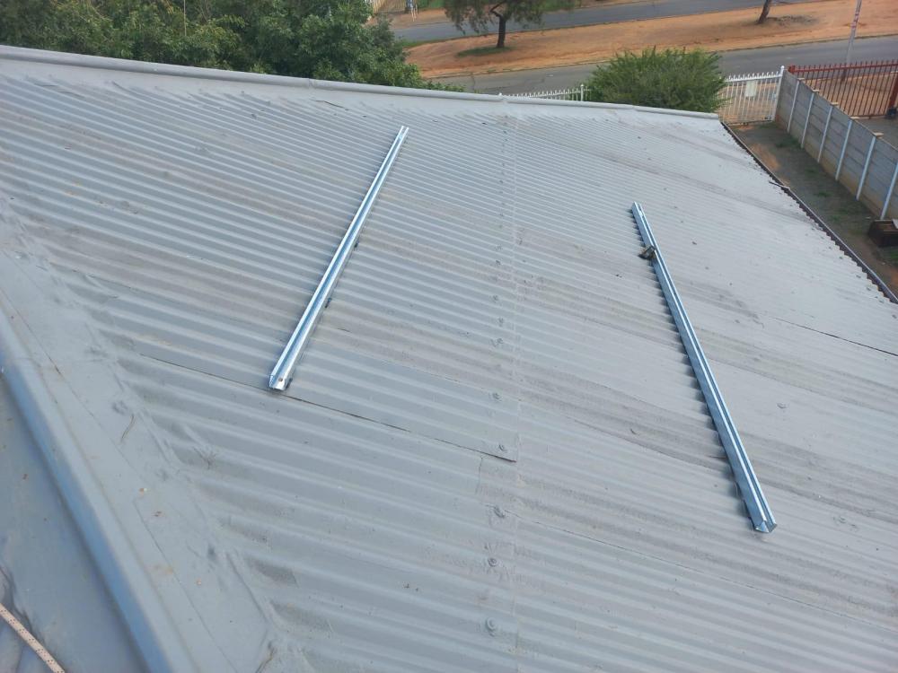

North side rails installed for 6 panels bottom and two top.
The Internet dish will be removed and the vent pipe redirected to front of gutter. Other pipes staying as is.
Not enough space to add all ten panels so the geyser panels will go onto the west side which gets a ton of sun up to 6h30pm in the afternoon.

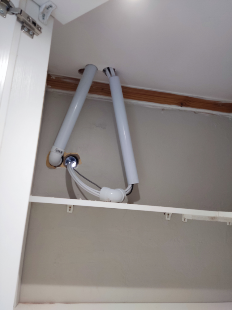

Each PV wire gets it's own 25mm conduit hole to feed plug and wire into roof. Connections will be done inside the roof. Also easier to then test panels if something seems wrong.

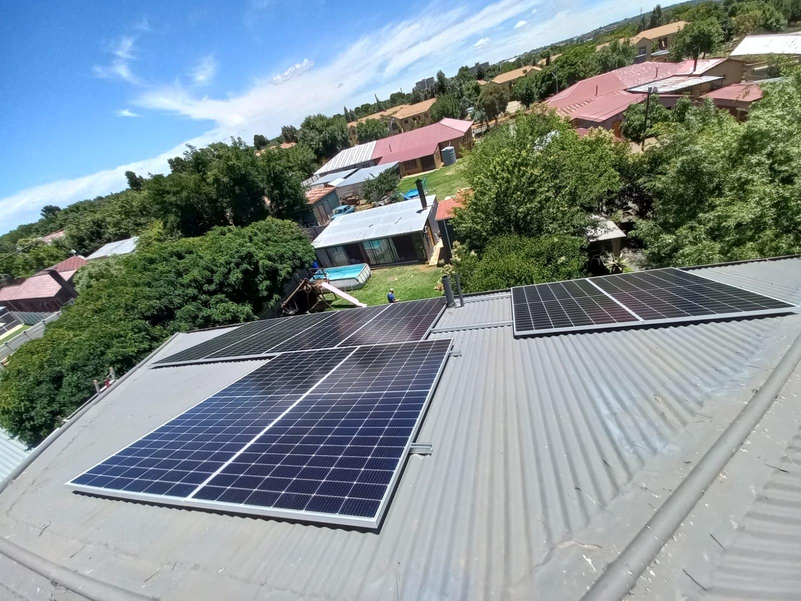

Panels installed.
Plumbing vents made it a tad difficult and doesn't look amazing but they are up there and been through a storm already. No leaks.
North for the 8 and west for the 2(geyser only)
